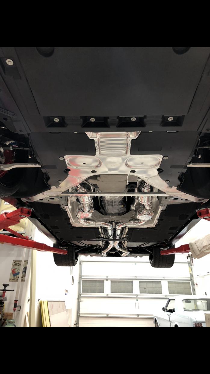

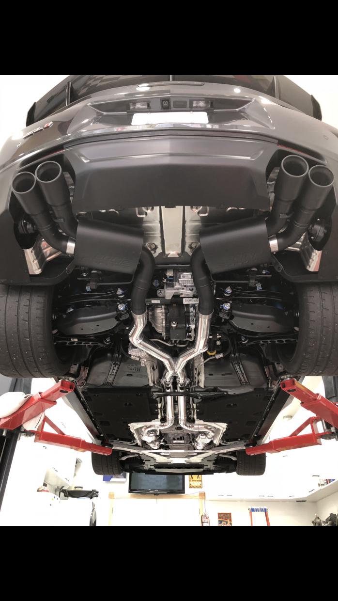

I ceramic coated the whole thing. I stayed with the factory cats but put on a Borla s-type catback. I have RaceDeck flooring in my garage. Before the coating the floor would buckle under the car from the heat. Now it still does but much less. My car spends a decent amount of time up on the lift since my OCD for keeping it clean won’t let off. Most of my vehicles get detailed on the underside as well as the usual top side.
