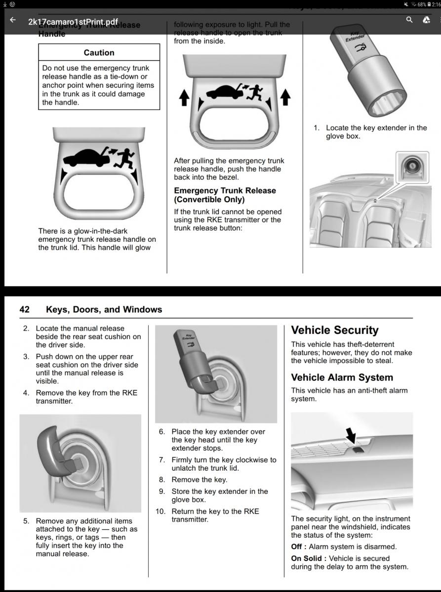

Posts: 654
Originally Posted by AmericanMike View Post
Key Latch? There is no key hole if that is what you mean. The remote and other trunk releases did not work.
From the manual
17rsvert is offline   Reply With Quote
oh wait, you mean the key hole release in the back behind the top of the seat back. They tried that too........ They had to get in the trunk and pry the latch with a screw driver.
So it wasn't electrical, it was a mechanical problem with the latch itself in your case. Now I get it.

Originally Posted by 17rsvert View Post
From the manual
Yes, but only for the convertible. I guess the coupe guys don't have that.
