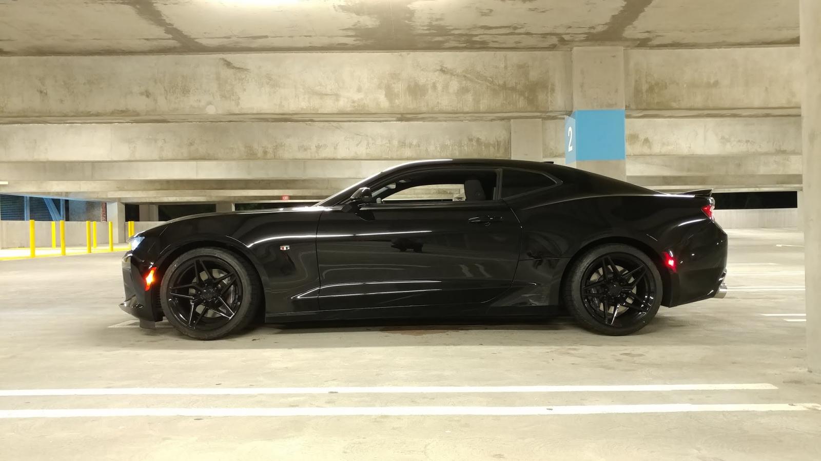

We have a dealer that did 18x12 front and back but is strictly a track set up, camber adjustments where done at about 3.7-4.2 and is running 315/30/18 front and back. no rear mods
since the only et i had was a 50et he needed to use a 2" front spacer
If anyone is ever in need of such a set up I can pass down his info/ he said he would be more then happy to share what was done on the car etc/
again was a track set up not a daily.

Anyone know what wheels those are?

I fit 18x12 square on my car, the front is very tight but it works without rubbing, there's definitely poke. I don't run this setup on the road.
