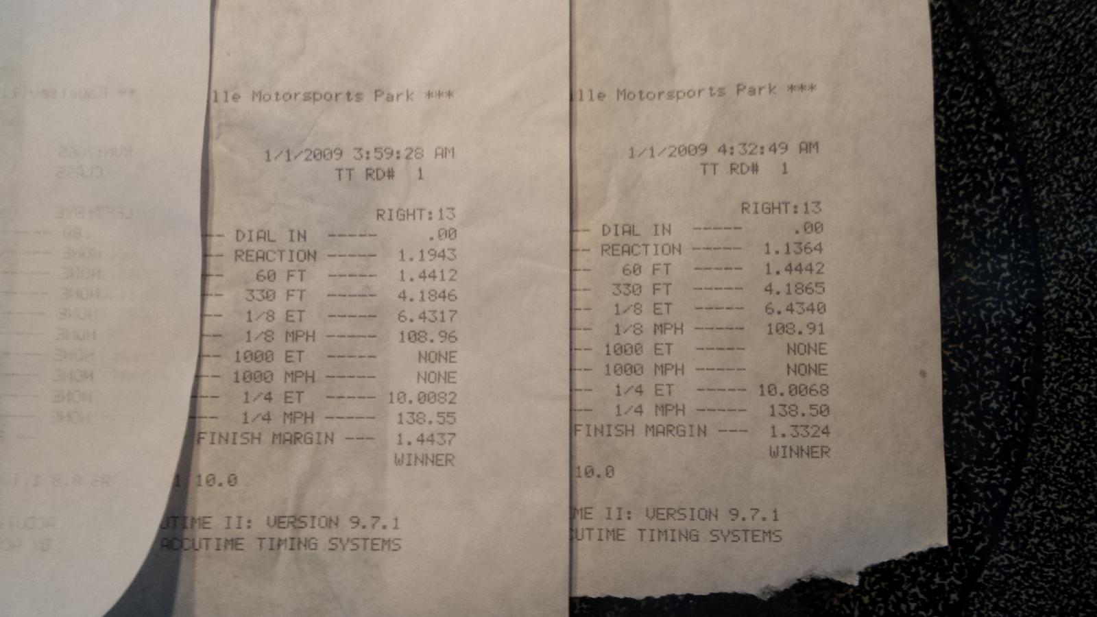

Took the car to a slower track today than yesterday but it was prepped better. I could actually launch the car and got the trans as dialed in as I could. I didn't change anything in the ECM. Once the car actually hooked I had to completely reset the shift points and converter lock up. It actually hit the limiter in first on the second 10.00 pass. The DA was -15ft and the wind was hawking but in every direction so I can't really say it helped or hurt. I have the vid if anyone can host it or drop it on their Youtube and post a link.
Again, this car is a fully loaded, full weight 2SS on a 28" drag pack. It has the stone stock long block to include IM/TB. All passes were done on 93 octane Shell gasoline. The only mods are:
Procharger P1X at 10psi@6,600
Alky Control single nozzle meth kit
Circle D 2D converter
Kooks 2" header w/ gutted cats
LT4 in tank pump
My ECM/TCM tuning
Attachment 922713
Completely amazing. So the TH400 guys stock engine... into the 9s no problems...
LT4 in tank pump
My ECM/TCM tuning
Attachment 922713
LT1 high-side pump?

Yes the car was relying on meth for fuel. The car now has full fuel system, cam and forged pistons...it's dipped into the 9's @141mph but I don't think its made a full clean pass since the setup in the OP.

It has now been 9.70's in 2,500 DA but still no full clean passes. I haven't touched the car in a while. We keep breaking DS's.
