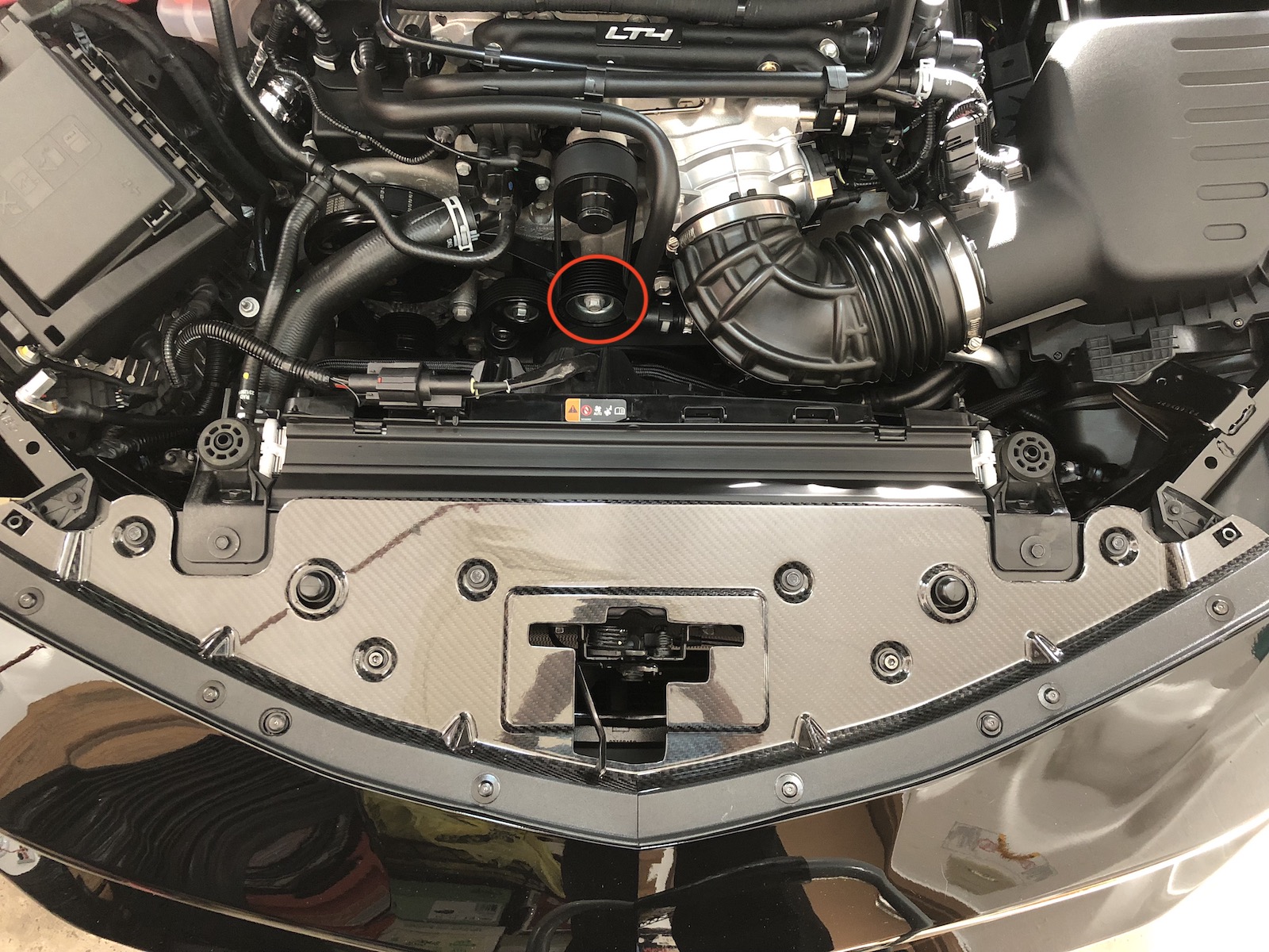

So, I just noticed this on my ‘18 recently. I’ve been trying to diagnose it driving and it’s been getting proressively worse. Opened the hood with the car running and put my ear next to the upper pulley, definitely the culprit. Guess it’s time for a dealer trip ��

My engine started to make a whining noise around 7000 miles. It sounded like it was coming from the supercharger pulley. Turns out the idler pulley directly below it had a bad bearing.
Diagnosed it by careful putting one end of a long wooden dowel on the pulley bolt and the other end up to my ear. You could hear and feel the bearing buzzing through the dowel. A long screwdriver will also work. Best diagnostic tool is an engine stethoscope, if you've got access to one.
