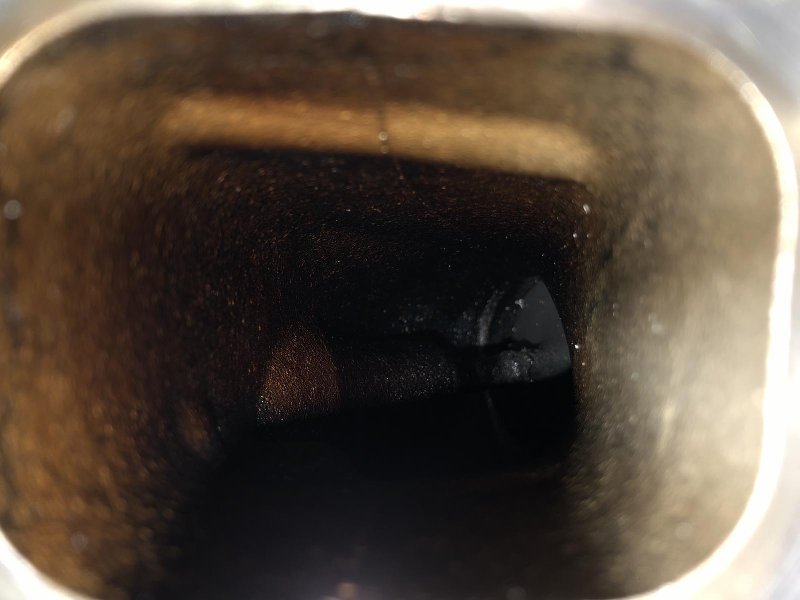

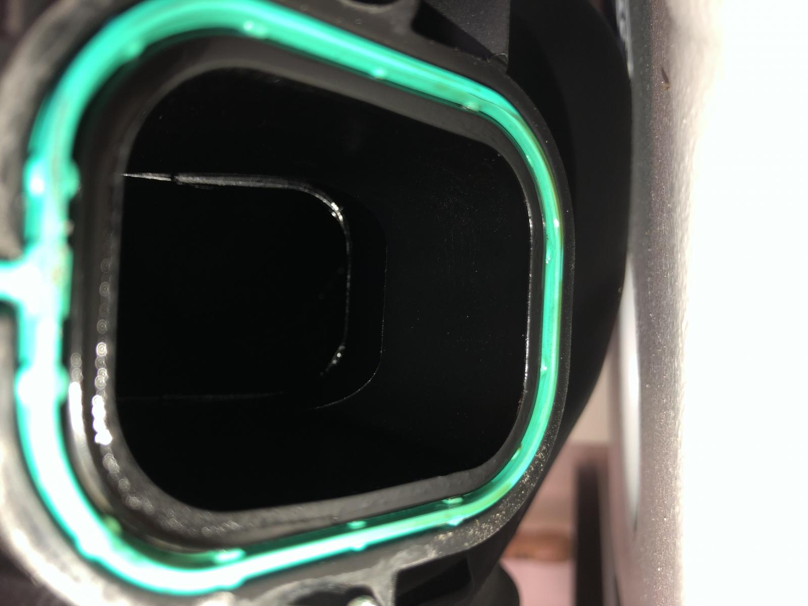

Over 200 posts and I think there's only been 1 person post pictures based on the questions asked? Here's my 2017 Camaro SS 1LE. Car has 16,xxx miles on it and is my daily driver. Pulled the manifold this morning took maybe 20 minutes. No mods, no catch can.

THANK YOU. That looks pretty much as expected. I hope those with 80k miles can take pics as well...
