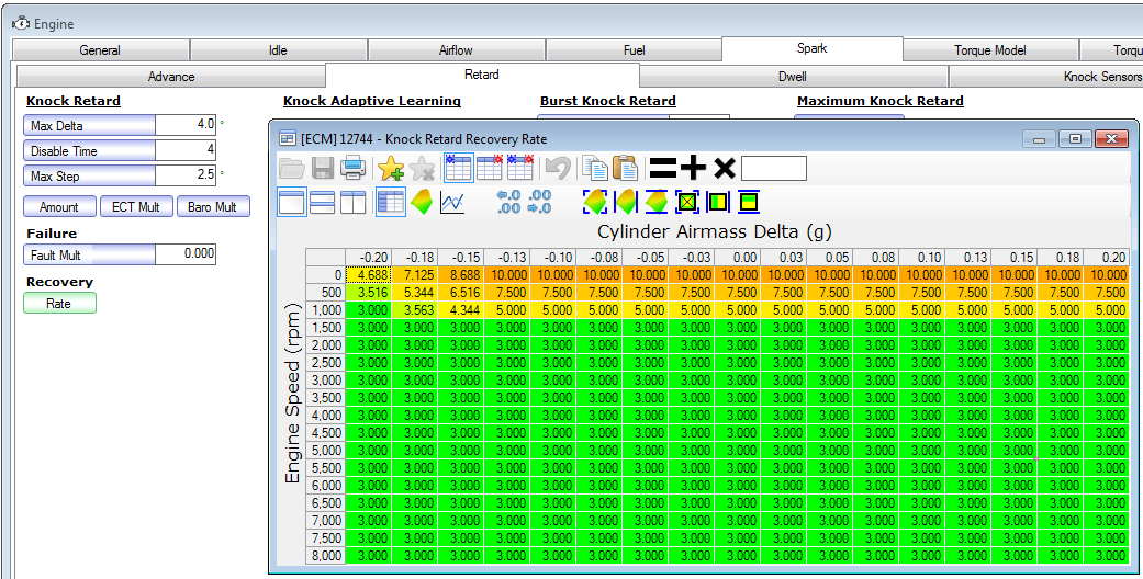

Has anyone with headers and mid pipes adjusted the knock sensor? I have been running the stock ignition map since adding the headers and always get knock on WOT. A/F is right on 12.5 so i have to assume this is vibrations transmitted thru the exhaust. typically its showing 1-3 degrees of retard. Any useful insight?

I had random knocks after headers/x-pipe. Talked with a few people an came to the conclusion that the LT1s are a bit noisier than the previous L99.
Adjust the recovery rate, so if it is false knock, it adds the timing back sooner and the threshold tables, so they aren't as sensitive (Cyl1 - Cyl8)
[ECM] 12744 - Knock Retard Recovery Rate: This is the rate at which knock retard is removed in the absence of further knock. The higher this value is the faster knock retard will be removed.
Knock Sensor Threshold Mult Cyl1: Multiplies knock sensor threshold when not in transient mode.

thanks man this is exactly what i was looking for, i will put in the numbers and give it a shot. ive been trying to put a little more timing in it but the engine hates anything over 21-22 degrees

It should take the timing after you make the adjustments to the tables pictured above. The knock sensor level table is the sensitivity.
