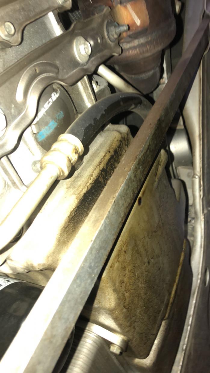

Leak
where could this leak be from ? everything seems normal to me

The hose could have a pin hole leak. Clean the area and recheck.

Looks like oil cooler line starting to leak.should be covered by warranty.This has been a typical gm problem over the years.Every GM vehicle I have owned has had engine cooler line and transmission line leaks over time.

Hopefully they warranty it out , i have A CEL due to having the AFM valves removed . So lets see what they say

Anything with a TSB should still be covered. That proves the mods didn't cause the failure because it's a proven issue on unmodded vehicles.
