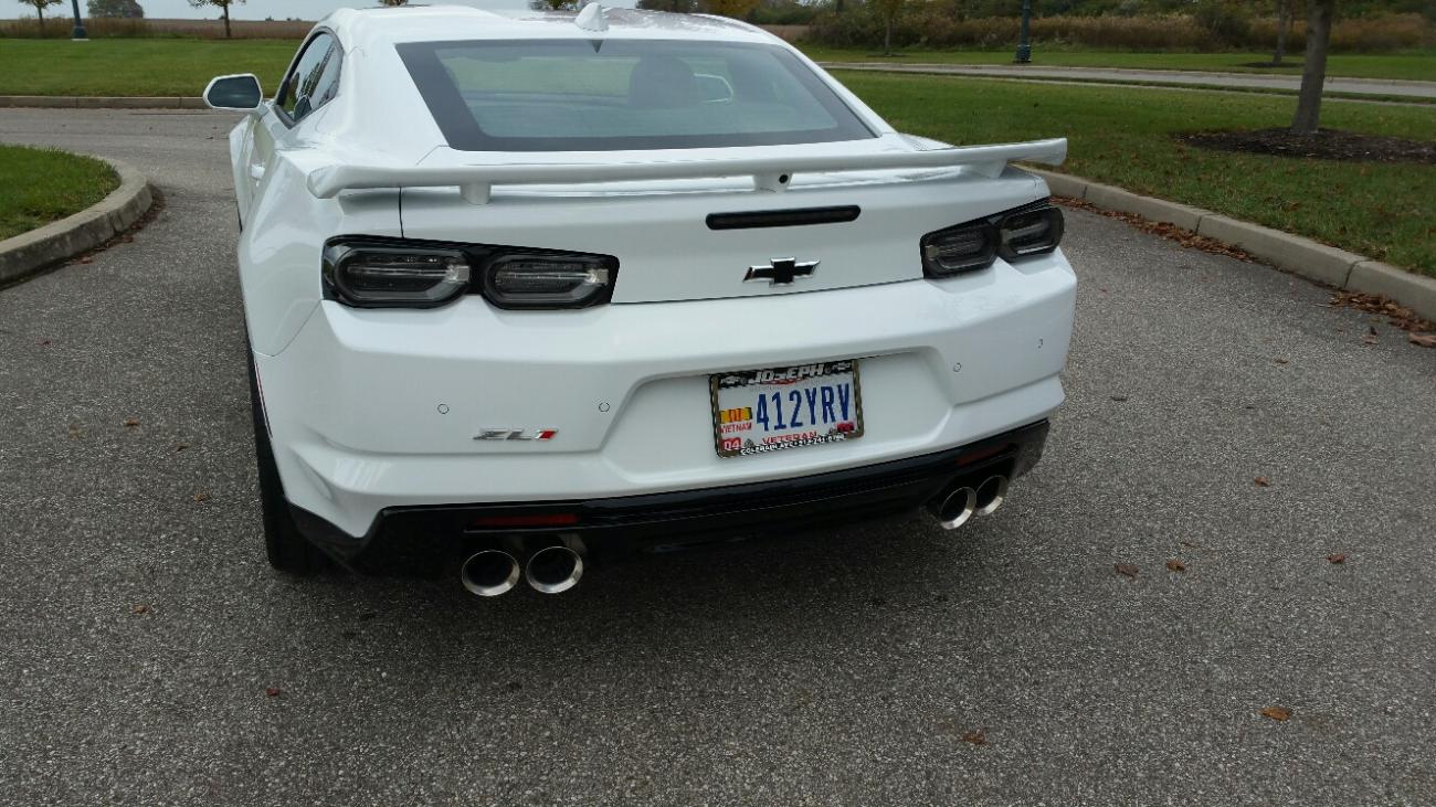

Here is mine and I really like them.
Beautiful car!
