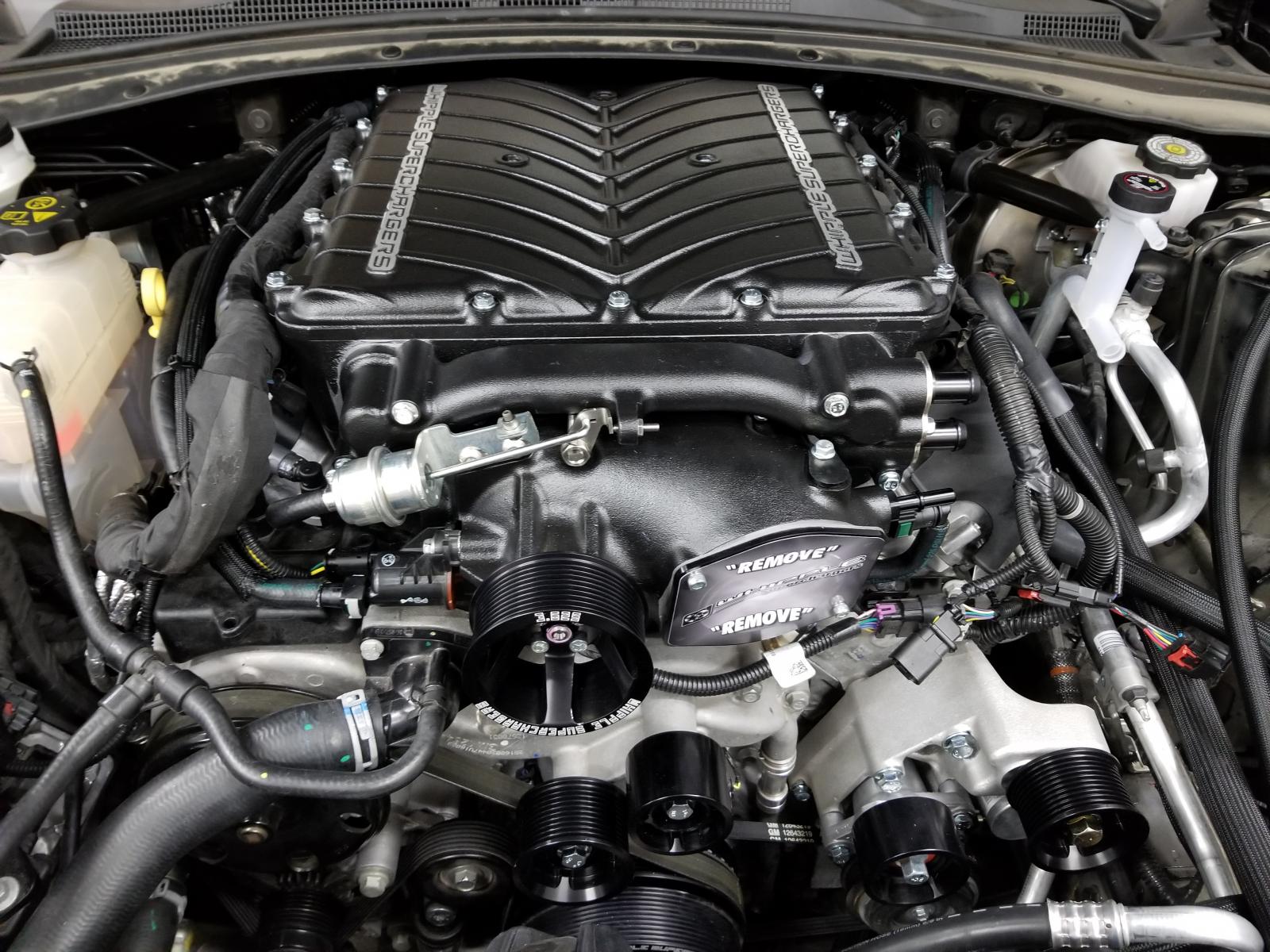

I received my Whipple Supercharger last week. I was confused when it came with the 3.625" upper pulley, when all of the other complete kits I have seen are shipped with the 3.50" upper pulley. I emailed Whipple to find out why I got the 3.625" pulley.
Here was their response:
"Your unit has the newer Gen 3 rotor assembly with a more efficient rotor profile and will provide the same boost/power as the earlier Gen 2’s with the 3.5”."
I will be curious to see what my boost is compared to the Gen 2s with the 3.50" when I finish up my installation this weekend. Almost ready to fire it up.[ATT

My Whipple(build date 1/18) came with a 3.5 pulley and it's a Gen 3 rotor pack. The kits can be ordered with different pulleys.
Is that the kit that comes with the Whipple supplied tune? I was at 8psi boost with the 3.625" pulley and went to 9psi boost with the 3.50" pulley. With 3.50 pulley I would expect the tune will have less timing advance to compensate for the extra boost.

Yes it was the supplied tune kit that came with HPtuners. I bought it off a guy bnib... He traded the car in because of converter shudder. Build date is 1/18.
