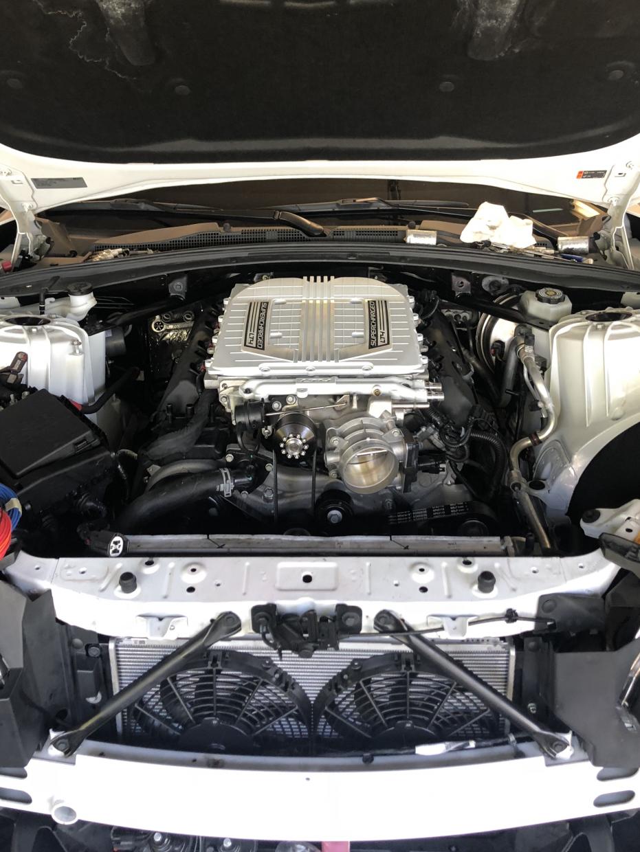

I also install fans on the Intercooler.... I’ll post pic

Spal fans

He’s absolutely right both the wires go together, fans looks good How are you going to wire them? With your factory fans or your intercooler pump relay or just a switch.

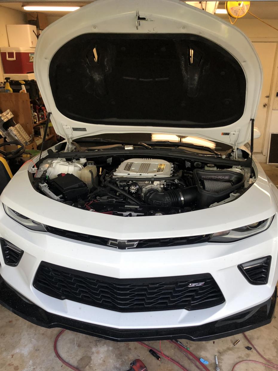

Looking Good Love the White supercharge with the white car.
Thank you for your business.

I gonna wire fans and pump together, then have a switch inside to activate both while car is off, while at track in staging lanes in between runs. I also plan on installing a remote Intercooler reservoir, to help increase System capacity.

Nice looking build. Attention to heat soak with the fans is a good idea
