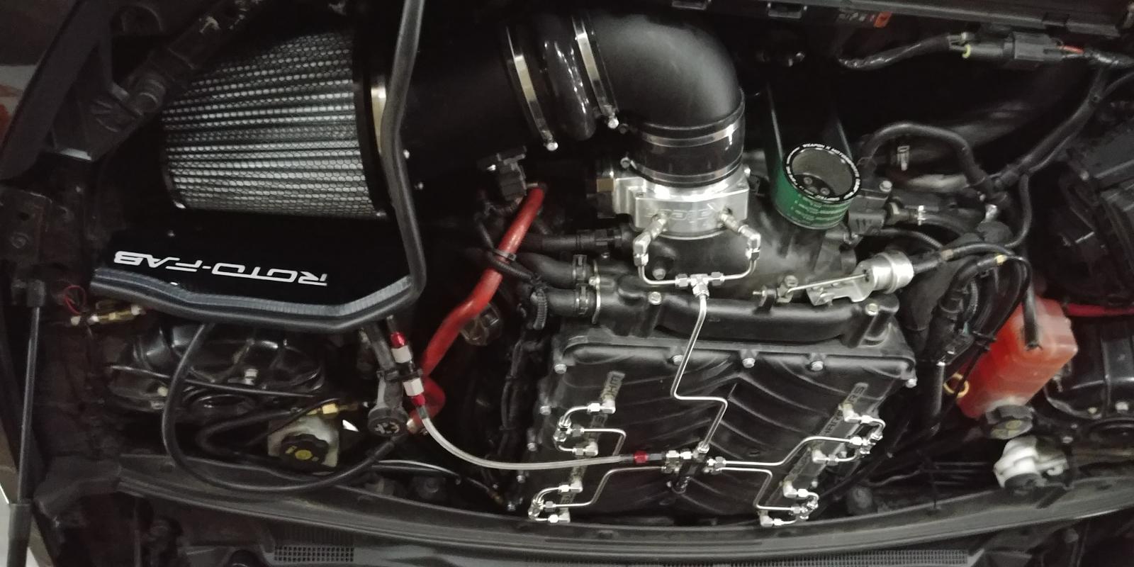

Have finished my supercharger setup
Tsp st1 cam and Tsp forged engine.
Tsp 1 7/8 " header with cat.
Around 770wrhp with 93 oct plus meth at 16psi

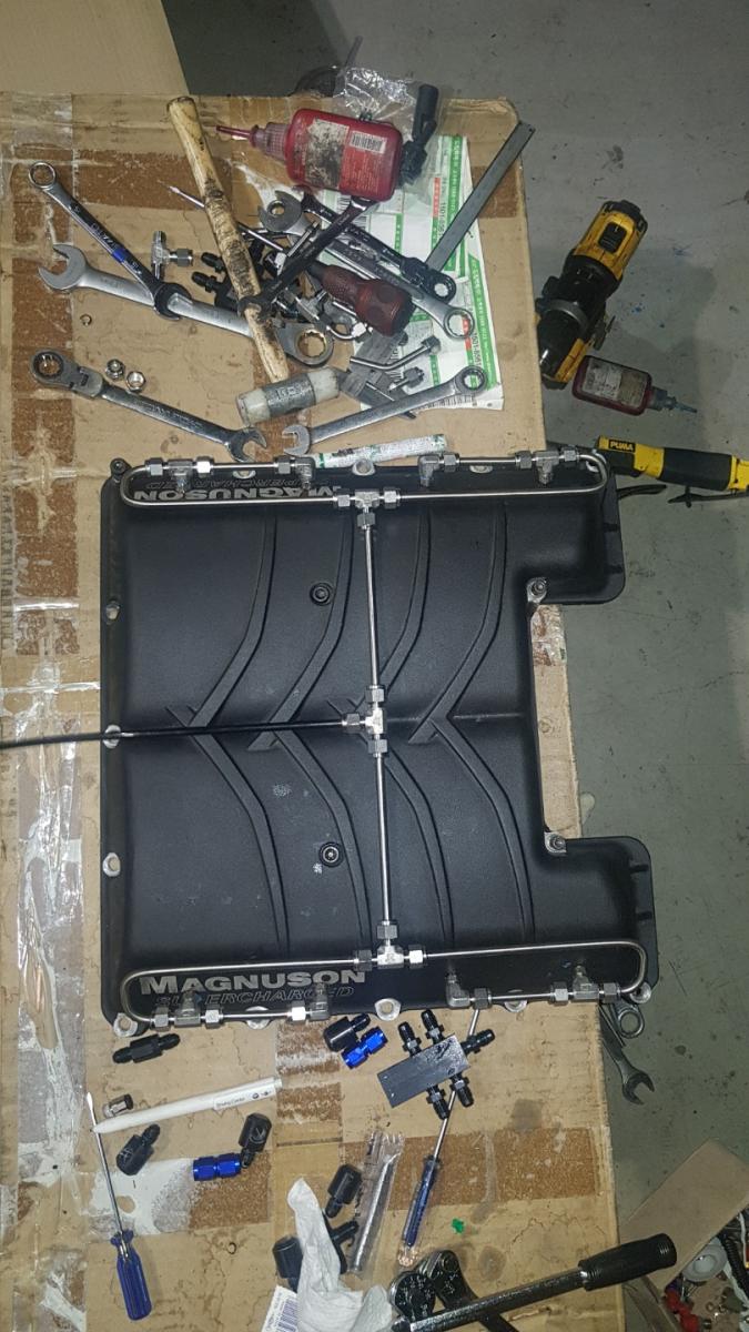

Total 11 ports . 89ml x 8, 560ml x 1 280ml x 2.
It was the first version, but it was ugly due to the lengths of hoses were fixed.

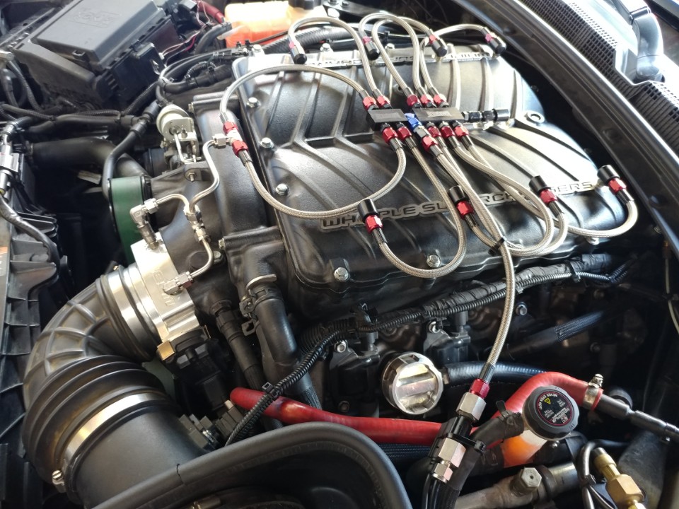

It came from Devilsown.
and his maggi setup.
