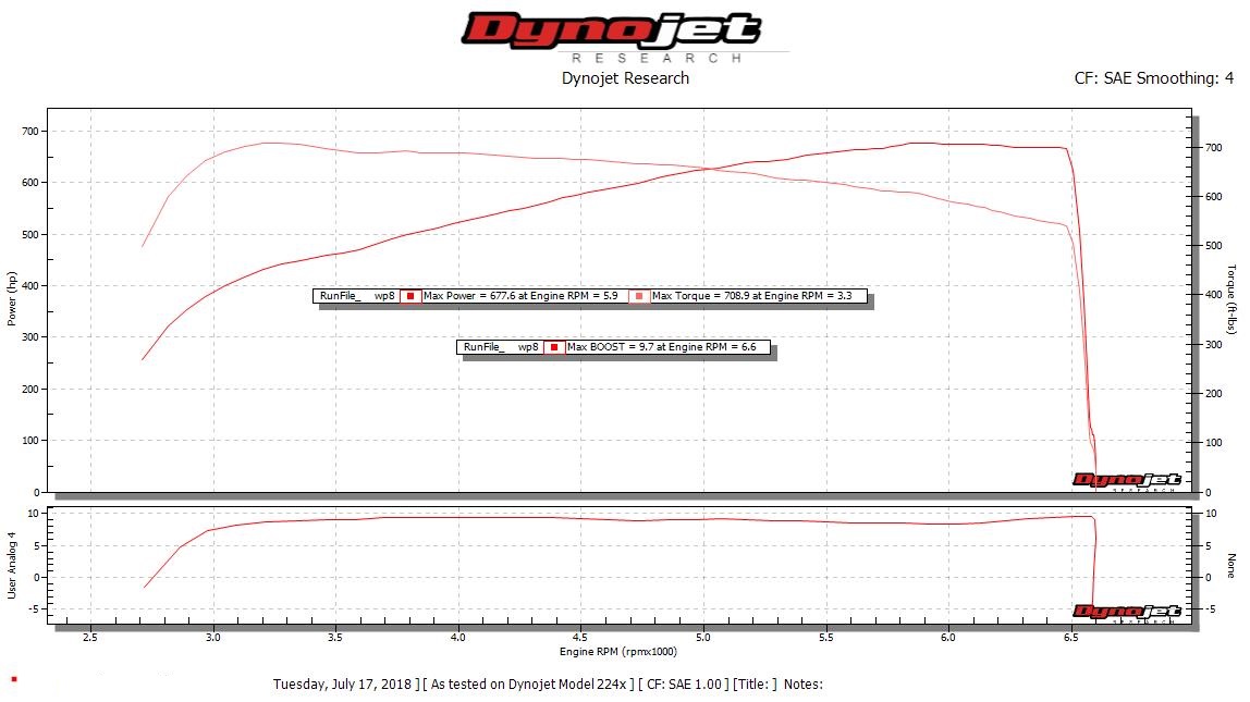

1LE Flex fuel update - LPE HPP
So we decide to bring back the 1LE we built for Danny that runs the texas mile on E85.
We added an LPE HPP and boy did it add.
We are now able to go from the standard 2.70 pulley down to a 2.35.
New numbers on 100% stock 1LE from the cylinder heads to the exhaust tips.

Wow that's impressive!. Great job!

nice results...looks like I will be getting a LPE hpfp instead of the LT4.

so is the bottom line boost: just under 10 PSI?
Yes
