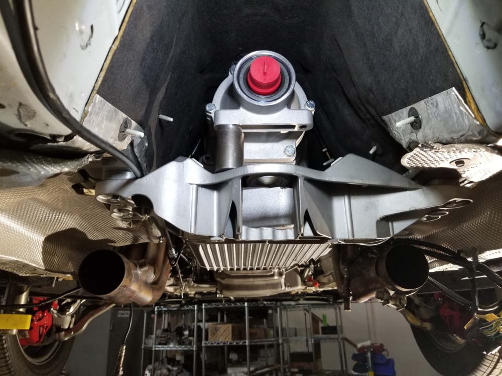

Well it's been a while since this thing has been at the track, but the final remaining part has just arrived -
THE DRIVESHAFT!
Car has undergone some serious changes and hoping to finally get back to the track for some shakedown passes on Friday.

So we've dropped the 8 speed auto in favor of an ATI TH400 with 4000 converter, tranbrake, and air-shifter.
Swapped out the stock rear for a G-Force 9" with axles and a 3.55 gear
Added an rear mounted intercooler ice tank and biger pump.
I'm sure we have a long road of tuning in front of us, but looking forward to gettin back behind the wheel again.
I'll keep you updated on the progress.

Why did you get rid of the 8l90? Because race car??
We hurt the stock torque converter lockup clutch from the second gear launches during Power Tour and not paying attention to the fact that it was set to lockup at 27mph. Had I noticed this in the cal and raised it it probably would have been fine, but since we had to pull the trans we decided to go with a more robust solution.
The A8 has a couple issues in a car at higher power levels;
First it requires a significant amount of torque management during shifts to keep it alive, when you're making 5 shift changes during a pass with each shift change requiring ~0.25 sec of reduced power this becomes an impact to the performance of the vehicle. With torque management turned off the trans will be lucky to make 2-3 passes before failure. The TH400 will not require any power reduction during shifts.
Also, first gear is too low at higher power levels, while this is the reason why A8 cars perform so well in a stock / slightly modified condition, it makes traction difficult with small tires with higher power.
