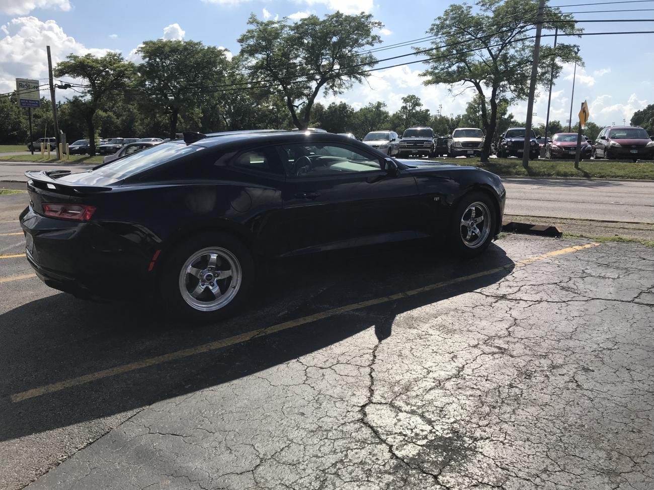

I run the 17x10 Weld S71 out back and the 17x6 up front. 305/45-17 ET Street R’s in back for now and the M/T Sportsman Radial up front in 28x6.
They’d work perfect for an AT car, but I’m going back to a Bias Ply next year with my M6.
They are expensive wheels, but I like them more then the Racestar’s
