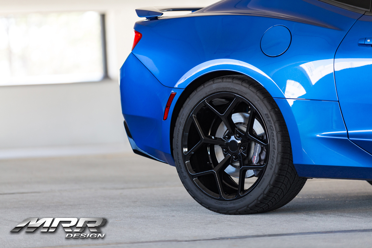

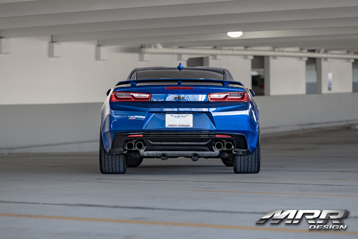

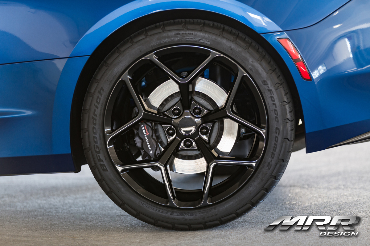

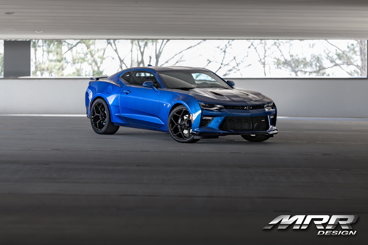

front 20x10 use the 25et
rear 20x11 use the highest they have which is a 35et but it will be aggressive because on a 20x11 is ideal to have a 43 off set meaning if you look at the picture below there wheel will be further out by 8mm
this car has a 20x11 43et
just to give you a idea.
if you do a 35et you may need a 295 to avoid any rubbing but will also look a little stretched
**** important **** also check with the manufacture to make sure it clears the caliper system on your car, you can have a 20x10 and 20x11 with the perfect off sets and be camaro direct but the design of the wheel sometimes will not allow to clear large piston calipers. ive seen some brands do replicas and still cant clear lol

Originally Posted by Carlos_MRRWheelsInc View Post
Not our brand but im willing to help out a forum member any time.
considering the off sets that they have available for you there is no need to calculate as you only have 2 choices for front and back/
