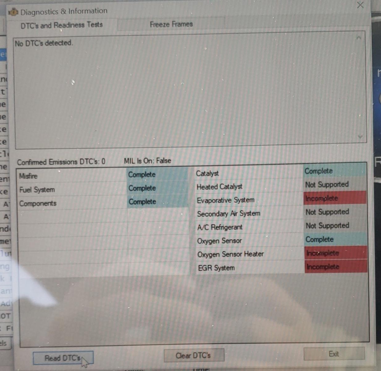

Here is the picture of what I see when I look for codes:

all the monitors in red are normal after a battery disconnect and will go away on their own. For me with a cam and a restrictor, the EGR will never go away.
