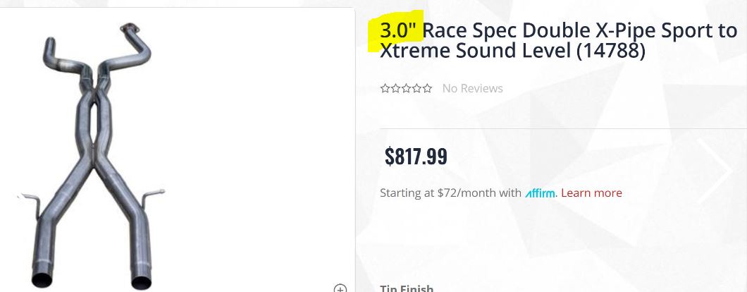

Correct on RDP... I wouldn't go with them even if it did fit.
The Corsa I posted is 3"

Attachment 951333
thanks mike.
Attachment 951333
I am aware, but notice how it attaches. Not correct for LT Headers. Compare it to Kooks X pipe pictures and you can see that the Headers both dump out at more even points and they're slide-over-and-clamp and not one clamp and one bracket or whatever you want to call the passenger side connection.
Here's a listing that will give you an idea of how their X Pipe (Meant for Headers only) attaches: https://www.kooksheaders.com/automot...shed-tips.html
Much different than the above Corsa 14788 which again is meant to connect to stock shorty headers and primary cats, exactly like the Borla 60606 that I run now. My mistake on 2.75", the 2.75" only applies to the axle backs.
