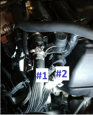

I'm Sorry, I am a bit dense.
I asked ADM for instructions and got this.
Drain intercooler or not. You will spill a small amount or you may not, either is fine
Remove the hose that goes from the supercharger to the pump. Install tank on stud on driver shock tower and install
Hose to Supercharger and other to pump.
Fill with coolant.
Okay, yea the reservoir is pretty obvious. But the rest of it requires some thinking. So now I am still confused. I also understand now I have to take the intake tube off for this. What a drag with the Rotofab, but okay this is worth it.
The kit supplies you with 2 hoses.
The short one with the factory connection goes from #2 above to the tank. Do I have that right?
But then I have an open spot tube on the pump.
But I have the second longer hose, does that go from the pump to #2. Is that also right? But then doesn't that leave another connection open?
Also removing the exisiting hose connections looks tricky.
Not a 10 minute install I think.

It’s actually pretty simple. You’re going to remove the factory hose (the one with the fill port) that goes from the intercooler manifold on the blower to the pump. ADM gives you 2 new hoses: 1 goes from the port on the intercooler manifold to the new tank. The other goes from the pump to the new tank.
And yes, you’ll want to at least partially remove the intake. I just removed the elbow section between the TB and air box on my Roto-Fab. Try to find the cleanest way to route the new hose, and secure it with some zip ties.
If I have some pics, I’ll post them.

Here’s a couple I took during the install. Not great, but it shows how the hose connected to the blower manifold, and a little of how I routed the new hose to the pump.
Oh...I also swapped out the worm clamps for factory style squeeze clamps. And I had to sand down the upper port on the tank. Mine had a big imperfection (looked to be from the molding process) that was causing a leak. Sanded it smooth, and all was good.
