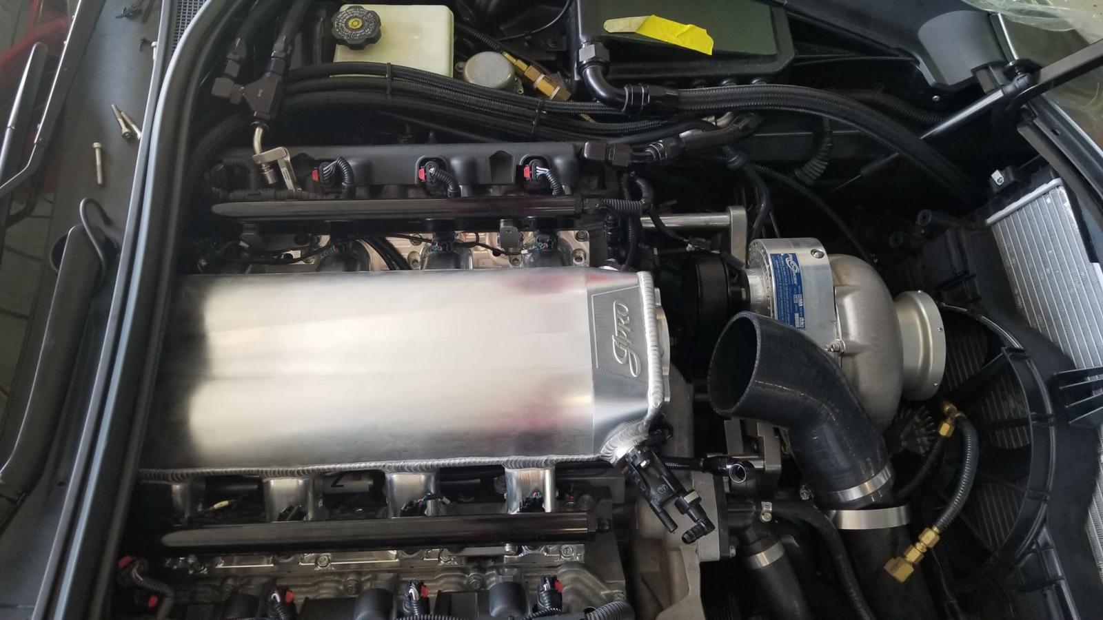

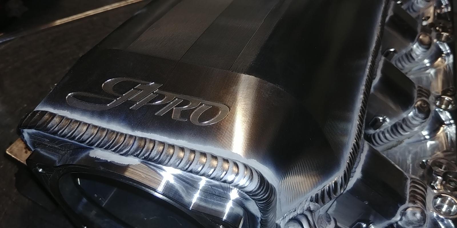

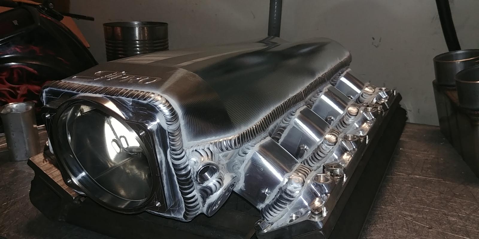

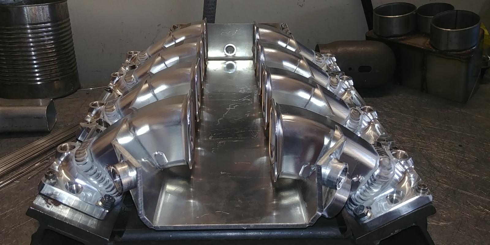

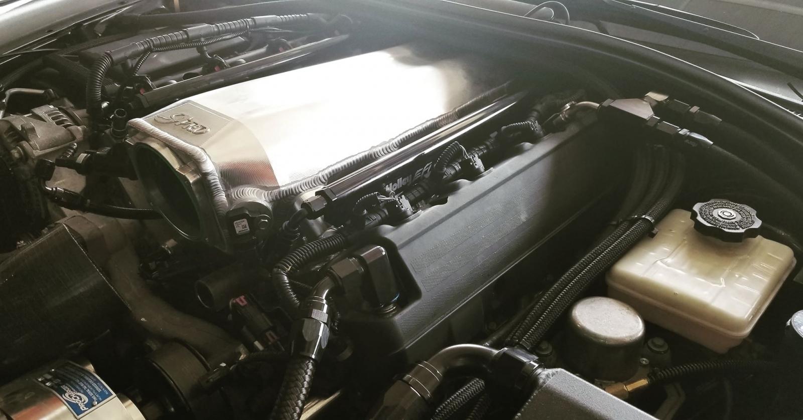

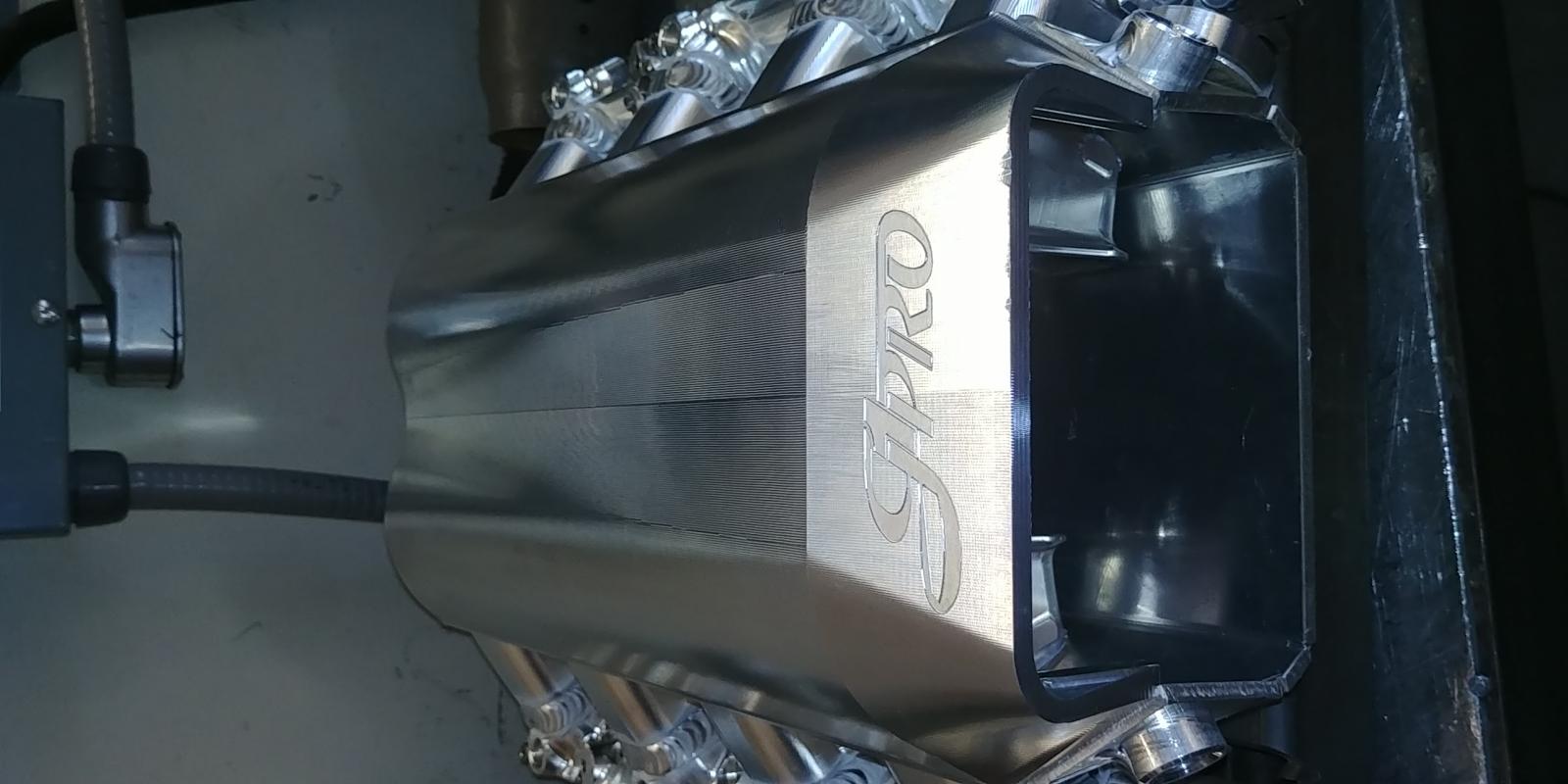

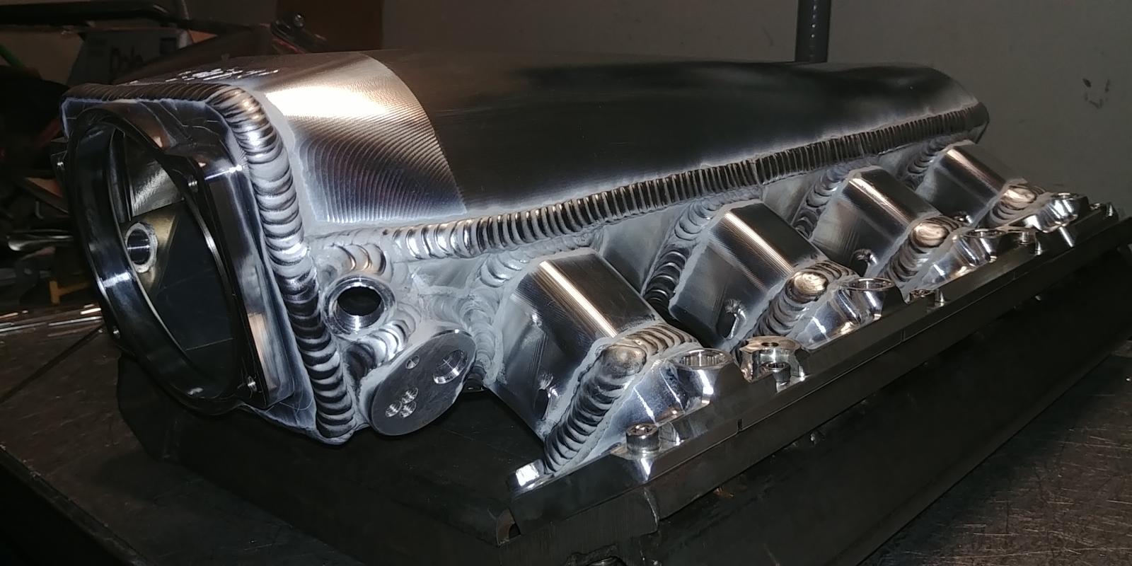

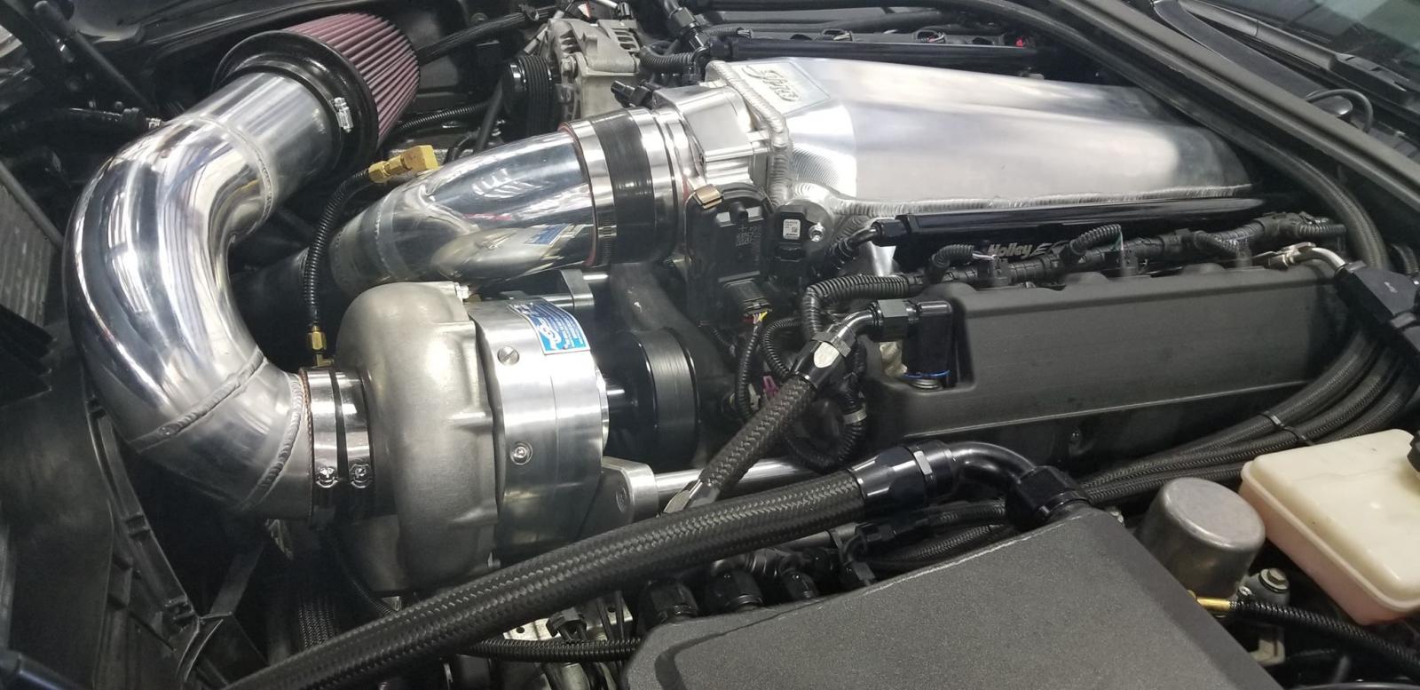

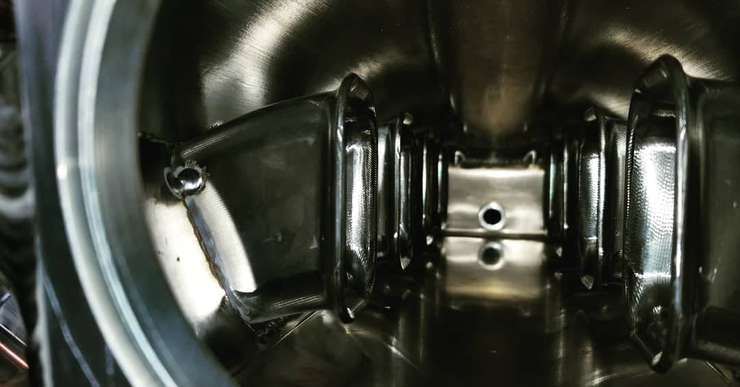

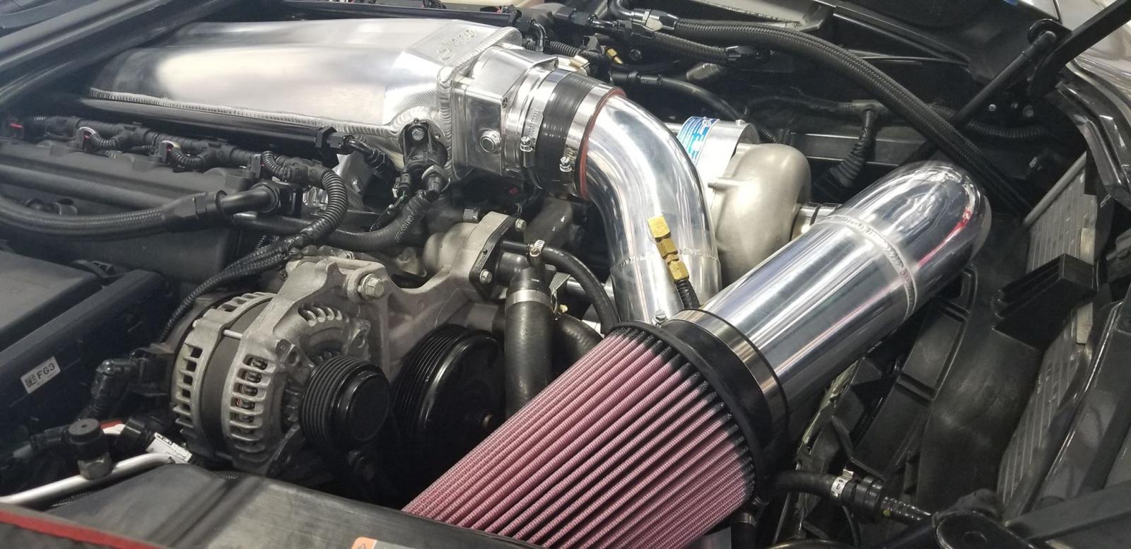

Billet LTx strapping down on dyno tomorrow
Stock LT4 long block
Will be getting tuned at Powerfab tomorrow morning so looking forward to some results

The shop I used in Dallas, AMP just finished a build on a new Z06 with a similiar intake to this one along with I believe a Procharger F1X and a custom made water/air intercooler.
The build was shooting for around 1500hp or so.
That is a nice intake system for sure.

Still waiting for final dynos to be sent to me. Also was told though the customer is being a party pooper and doesn't want me to post up charts.
Soooo
I'll say*
83whp gain
Prior was 19lbs boost
No air filter, bellmouth on blower
This time 18lbs boost (less restriction)
full air filter
Soon as I can get the final charts in my inbox and official approval from customer I will post the charts.

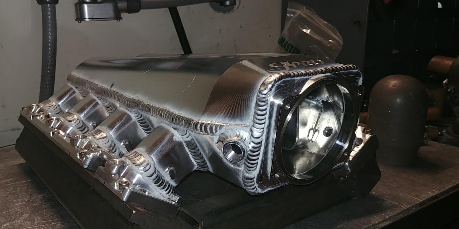

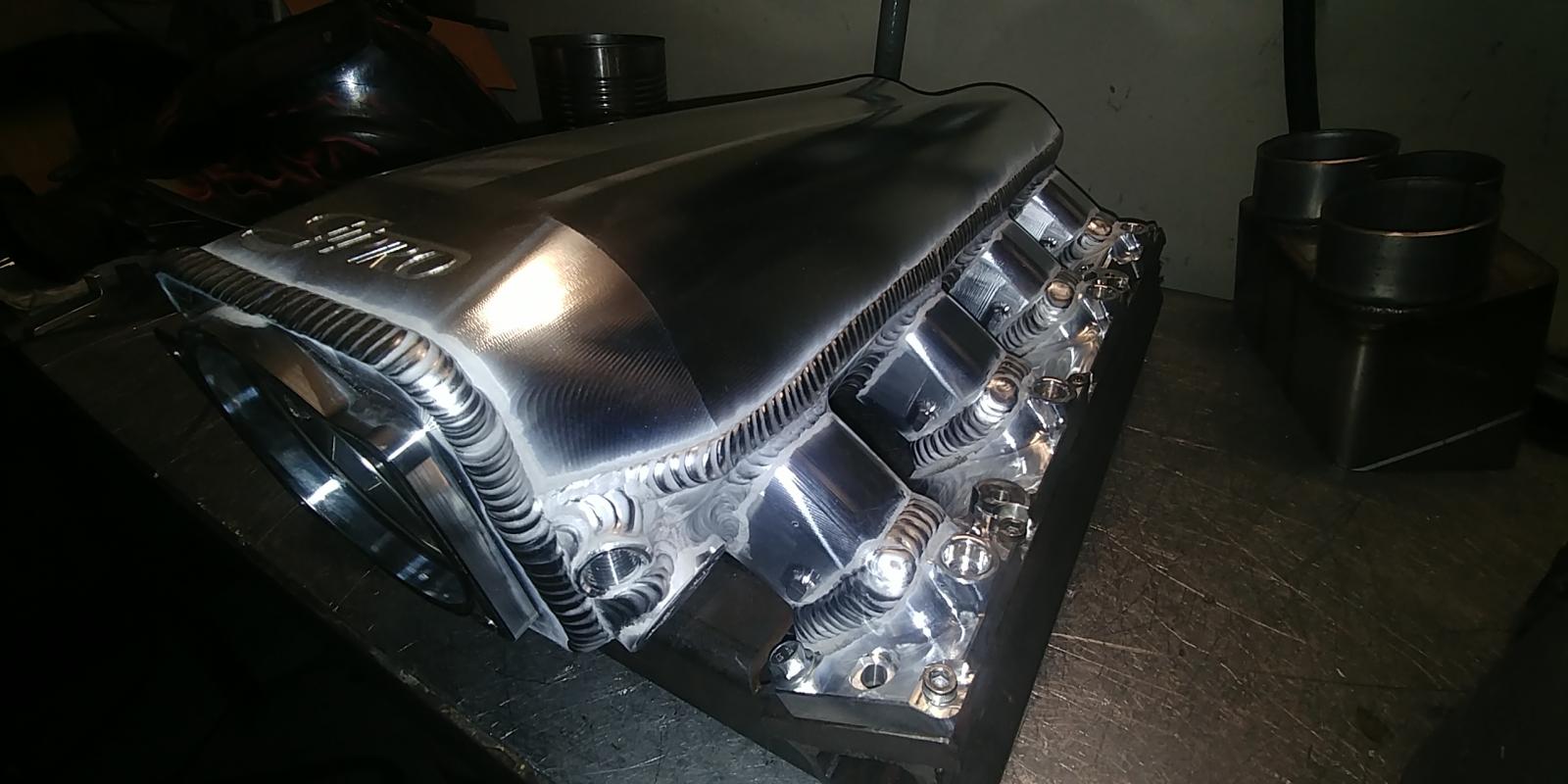

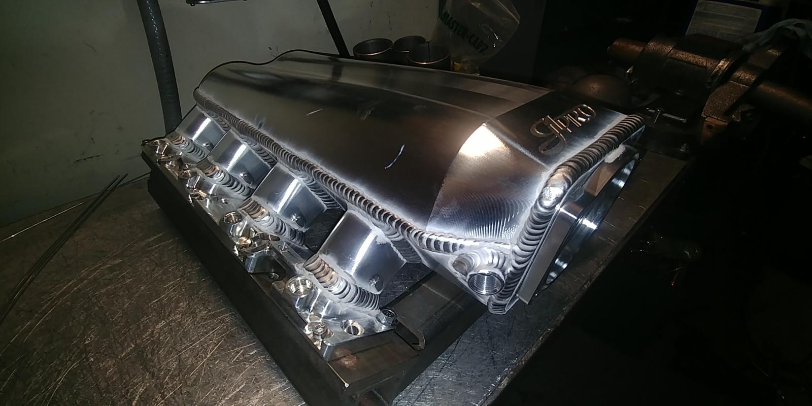

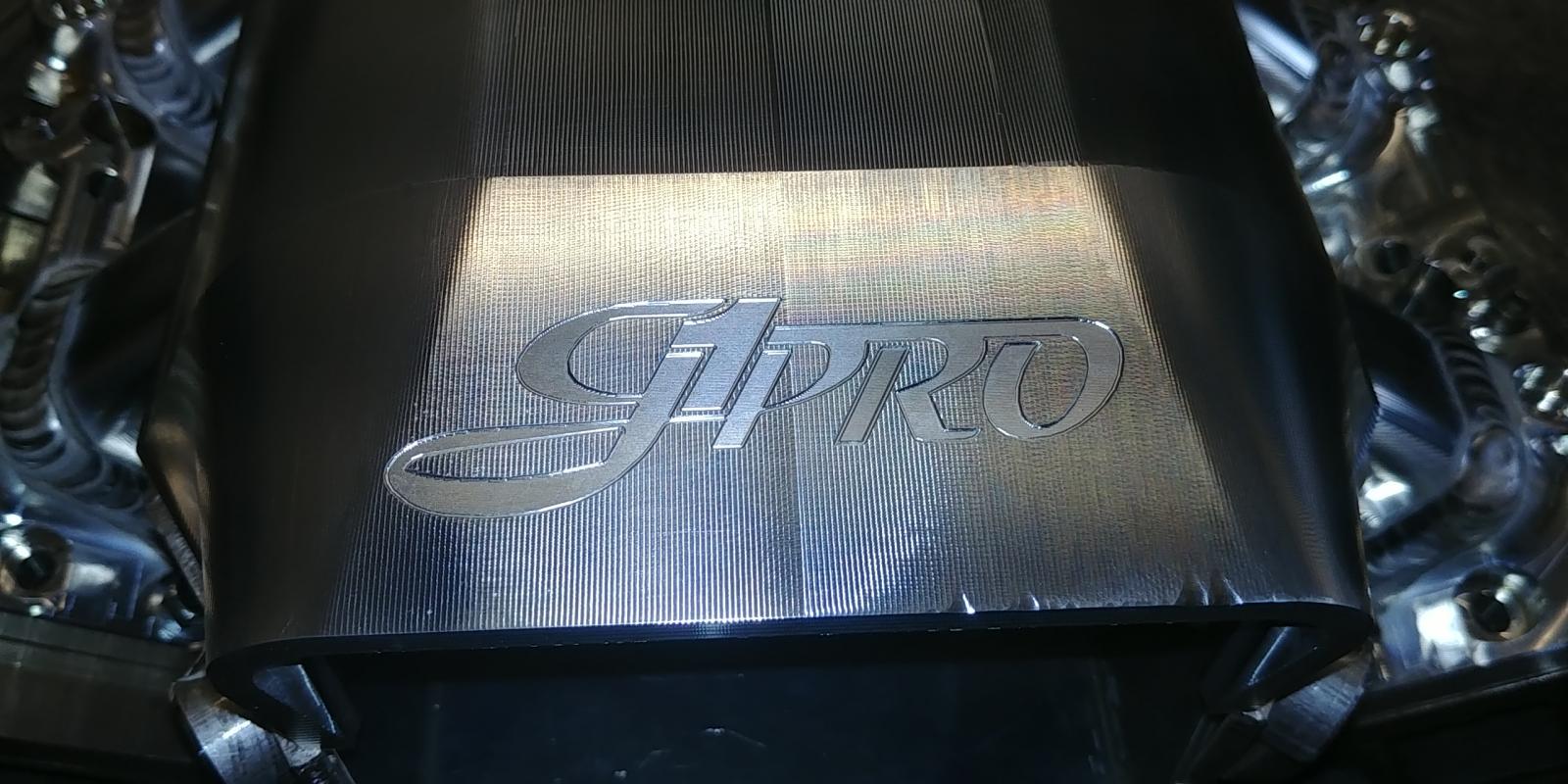

Another one shipping out tomorrow morning!

What an Artist and Fabricator. Man that Manifold is just wicked.
