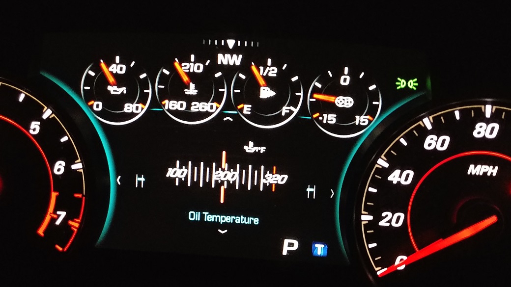

I have DRs and a Rotofab, so 10s should be possibly possible. I am stuck in the 11.4s. I have yet to beat my best 60's stock with the 17" ET SS Mickey Thompsons. But to be fair to the tires I only have a few runs on them.
The other problem I am having is if there is too much time between runs the car cools off too much and timing is pulled and MPH drops like a stone. So I keep the hood down and need to start the car at least 5 minutes before a run and I watch the oil temp gauge. The one below is not quite there. The bar needs to split the 200. There are 10 quarts of oil in there! Others must also have this problem.
Also my ZL1 is low on MPH compared to others. in -1500 DA 1/4 tank all stock I could barely touch 126. Usually I am at 122-125.

Fraxum, that sounds almost totally backward. A cool engine should pull less timing than a hot one. Sure. You need the oil and trans temps to be warm, but you shouldn't have to make sure they're at 200. The only issue I've ran into with temps being too low was when the trans was below 150 and it was slow to shift into 4th and caused the car to hit the rev limiter. If you're not cooling that supercharger down, you're going to be giving up some mph. I keep my hood up as much as possible between runs and while sitting in the staging lanes. Don't idle the car while sitting in the staging lanes either, because that will heat you up in a hurry. If you can't pull right up to the lane to make a pass, shut it off and pop the hood. Try to keep the sun off of the supercharger too. If you have good cool air, say 50 or less, and can lap right back around and run again, the car will stay good and cool and mph good for 5 or 6 back to back passes or more. When it's hot out, you'll see a mph drop on your 3rd pass. The supercharger should feel cool to slightly warm to the touch. If it feels hot when you touch it, you're leaving a good 2 to 3 mph on the table.

Temperatures are a valid concern. I've been dissecting the tune in my Hellcat and it has torque management tables based on engine oil temp, engine coolant temp, air charge temp, and intake manifold temp. The EOT and ECT there's a sweet spot of temp range where it gets the full monty, too low or too high and it dials it back. For ACT and IMAT too high it dials it back. So you want warm fluids and a cool intake.
