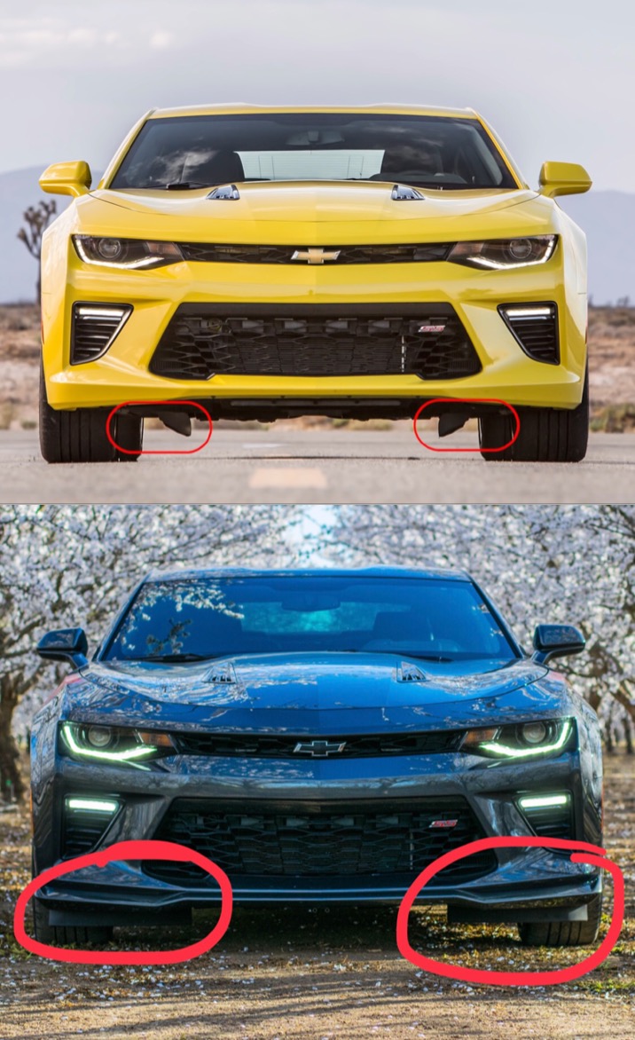

The front air dams( the part numbers you listed anyway) are what is attached in the picture below right in front of the wheels. To my understanding, they are for high speed aerodynamics in reducing drag therefore improving fuel economy. They should be installed, but not critical to anything. They are NOT the brake coolers others are thinking you're talking about.
As for the rear parts, those are the lower control arm covers. Those SHOULD absolutely be installed. They will prevent mud, dirt, and other debris from building up on the control arm and other components. Those are just not for the track.

I’m sorry, are you referring to the items in the red circles here? I wanna make sure I’m talking about the right thing.
Part number 23408773(4) refers to the items in the second picture.
https://www.gmpartsdirect.com/oem-pa...ector-23408773
Part numbers 22823592 and 22823593 are the lower control arm covers in the back of the car.
https://www.gmpartscenter.net/oem-pa...bC1sNC1nYXM%3D

Ok, completely my fault here, I was mistaken in what I thought you were referring to.
Your dealer is an idiot. Please refer to the first post here by ChevyRules for the correct answer.

Rear control arm covers = Always On
Brake Cooling Duct (and associated parts) = On for track/summer use.
Front Air Dams = Off for Track Use
