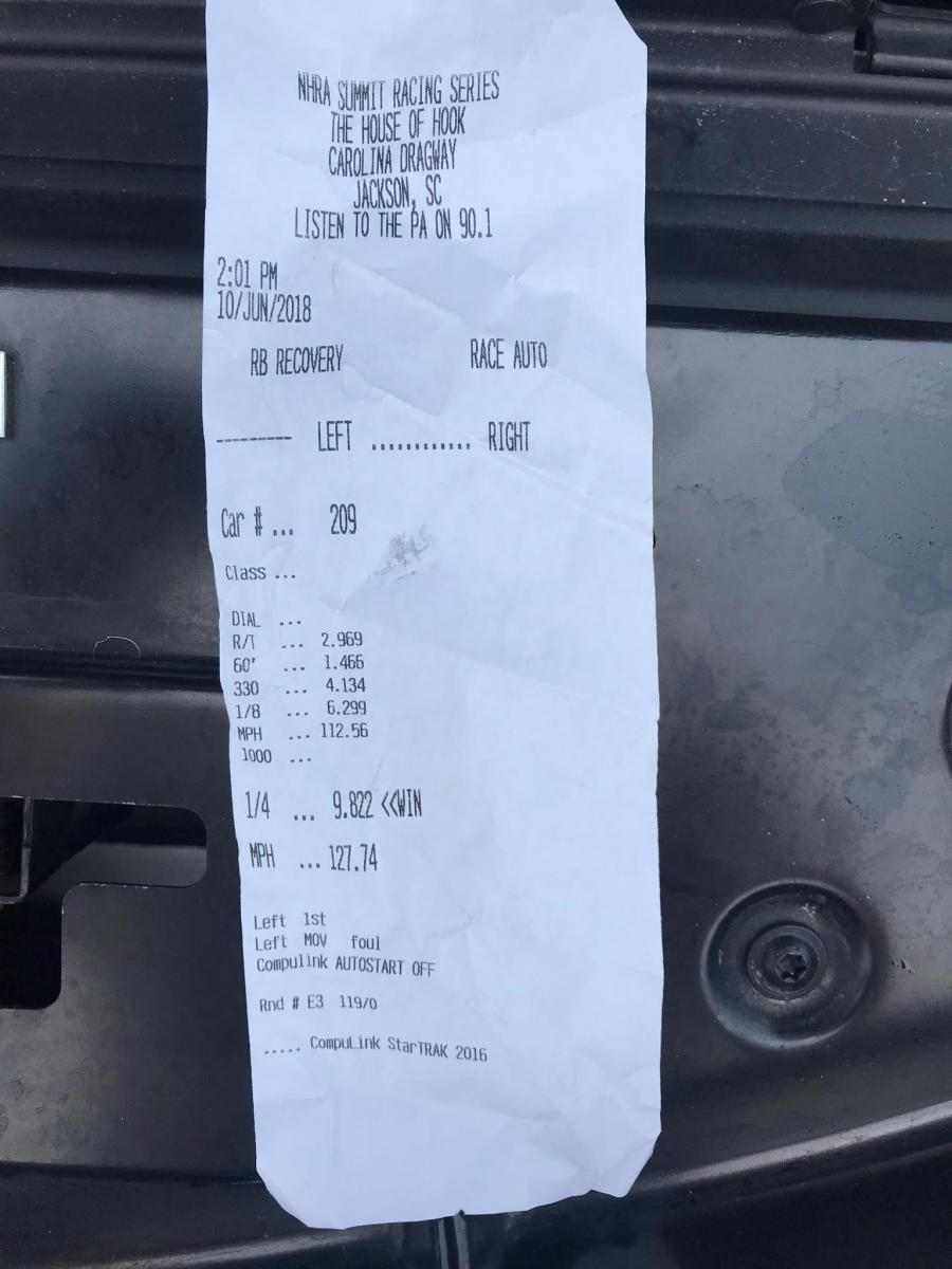

First customer pass after the cam. Another P1X record.
Customer picked up the Silver Bullet and drove it straight to the track. First pass off the trailer at full weight. O tuning yet. Lots of work to do. He let off right after the 1/8 to not get kicked off the track. DA is +3K.
Mods are:
PC P1X
PP STG 2 blower cam
Fuel
Meth
Headers
Drag Pack
PP tuning

No Cam tuning Run's a 9.8? wow!
I plan to fire up that stg 2 this week. Can't wait!

Has my STG 2 cam. He let off at the 1/8 and still ran 9's. LOL.

Man I wanna see a full pass bad , what mph are you thinking when everything is dailed in?

That is incredible! Based on the 8th mile times, you will easily be in the low 140's, right? What rwhp are you getting with that setup
What tire combo was he running?
Congrats on the great work!

Thanks for the kind words guys.
In a couple hundred foot DA we went 108+/138+. So we picked up 3.5 mph in about 3K higher air in just the 1/8 with similar 60fts. We can basically call that a 6 mph gain in the 1/8. If I apply that math straight across that puts us at 145 on a good day. Possibly a little faster. On the dyno we clipped 190kpa at 6,800rpm. We only hit 170kpa yesterday. That is a bit of boost to lose. Not sure if that is real world belts slip or simply due to the weather differences between the two days. Also on the dyno we were at 11.7-12.0 afr. Watching the little vid from yesterday we are way rich. The customer is putting a WB in the car so we will see what's really going on.
Looking at the log it short shifted the 1/2 and held the 2/3 and 3/4 a little long. There is a bunch more in the tuning right now. When winter comes and we can get some - DA and full boost this thing is going to fly.
It is currently running Racestars on a 305 Mickey R on the rear.
The car made 785rw at 190kpa in 5th on the drag pack with 100 miles on the motor.

I wanted to see a full pass as well but a car flipped 6 times down the track and the driver had to be carried out so that kind of ended the day. The tires need a rebalance or there is something up with the DS. They are going through the car today to ensure everything is straight for the next outing.
