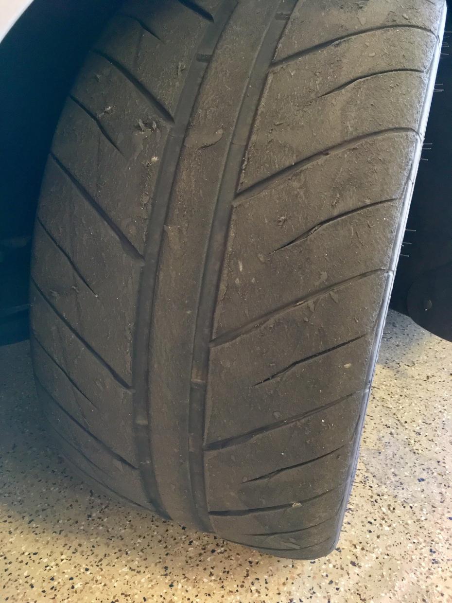

I’ve been running a similar setup on ZL1 1LE reps for the track. Hankook R-S4 305/30R19s on 19x10.5F and 19x11R. No spacers needed.

After six full track days in AZ heat
