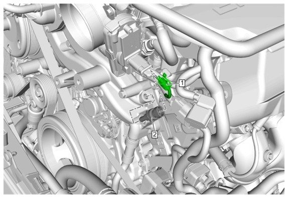

Could you maybe take some pictures of all the connectors that I should look into ? This would help me identify and then check what is going on with them.

This view is with the air duct removed. Coolant sensor is #2. The connector is #1(shown unplugged). Black/white wire is signal ground. Blue wire is the signal. Check the sensor, connector and both wires.
Thanks! This one I did check and everything looks nice and tight.
