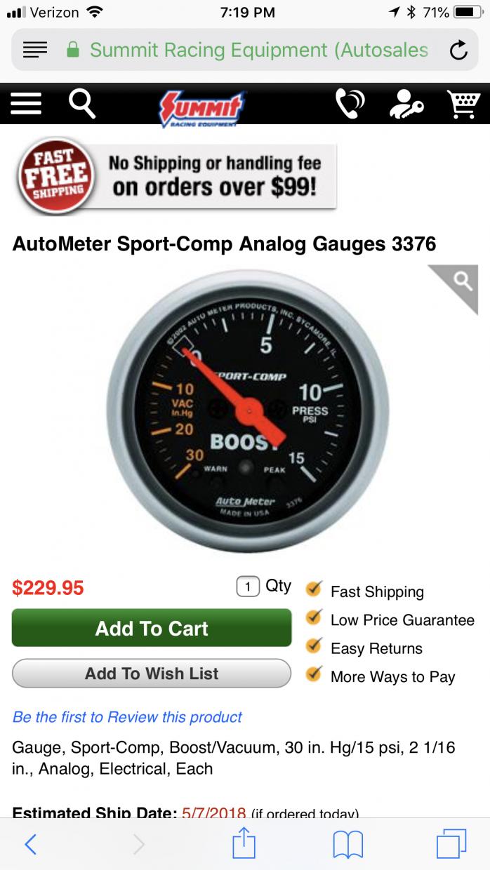

I would be interested, due to my age in this adult toy, does it fit in either of the two common pods? Please provide the part number of toy....
This is the one I got. I don’t ever plan on running “high” boost numbers, so 15psi is good enough for me.
But if fits in the vent pod without and issue.
