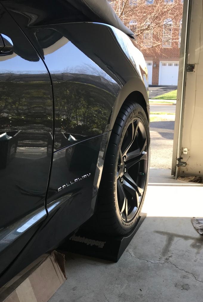

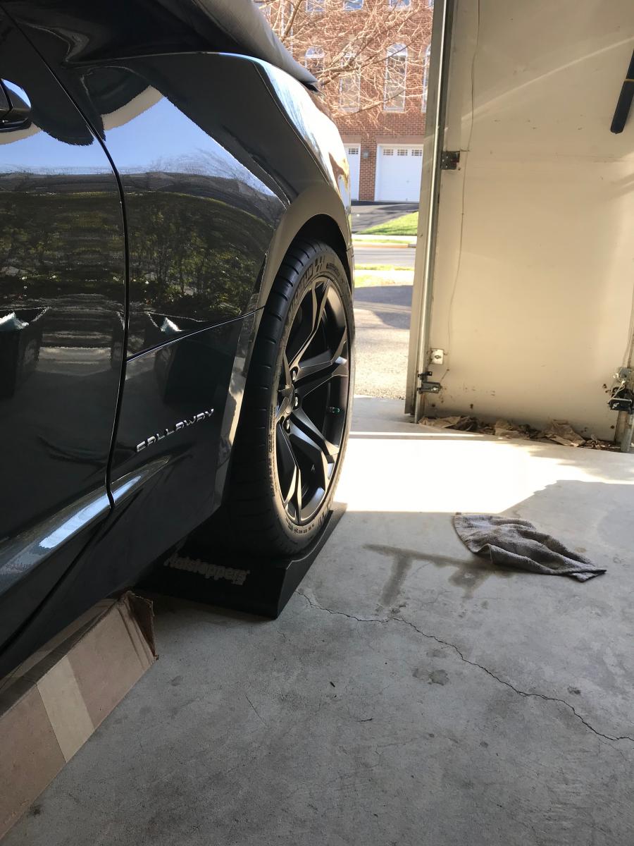

Attached is a picture of the rear wheel well. I rerouted the wire harness and add the push rivet to make sure the tire will not rub on the liner. I also took a picture to compare the width of the stock rear tires with the MPSSs.
Did the push rivet just push back the liner a little? Is this why you used one. I'm guessing you used an existing hole too.
1hprush is offline   Reply With Quote
Old 04-07-2018, 12:33 AM   #23
Mrfixxit7
Mrfixxit7's Avatar
Drives: FIFTY 2SS Callaway
Join Date: Sep 2017
Location: Kansas City, MO
Posts: 203
It pushed it back quite a bit at least 1/2" and I did use an existing hole.

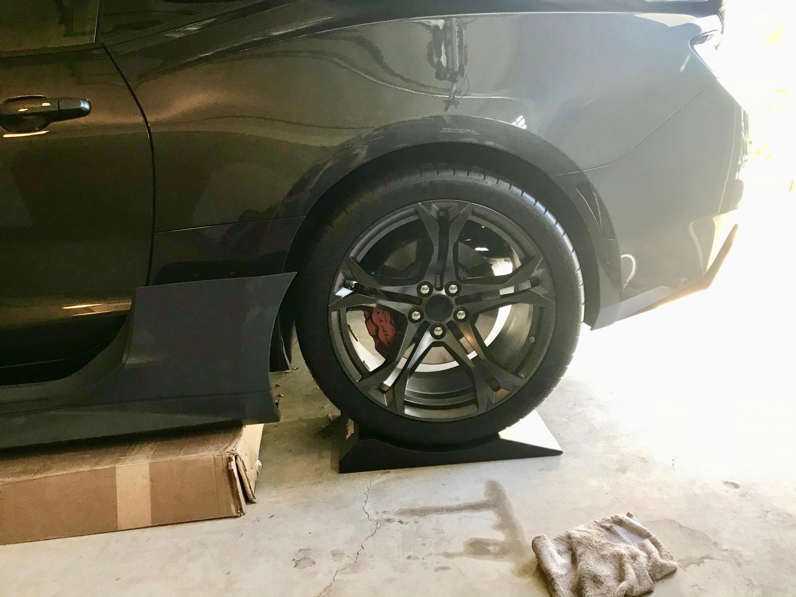

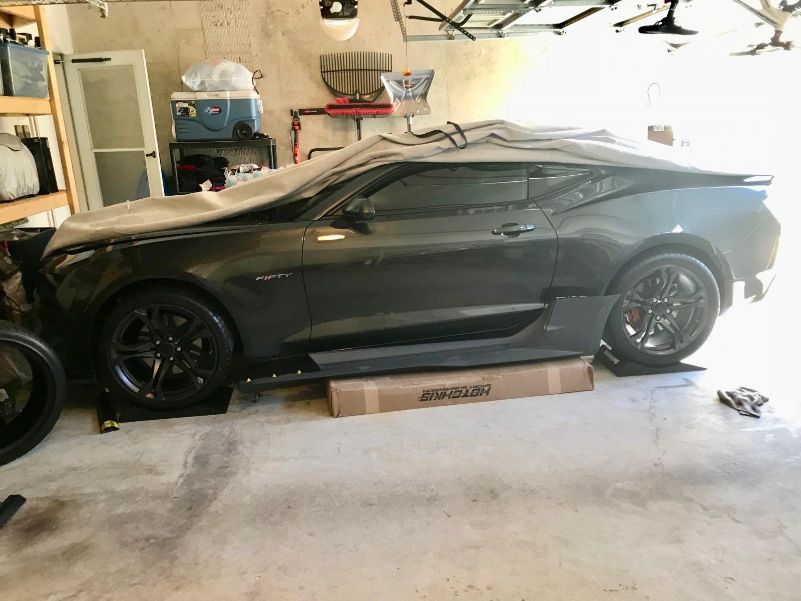

Can you post a pic of those rear wheels on the car. Would like to see how much sidewall there is.
Old 04-07-2018, 01:08 PM   #25
Mrfixxit7
Mrfixxit7's Avatar
Join Date: Sep 2017
Posts: 203
Here you go. they are not the best and the car has not settled from being jacked up recently and I still need to get an alignment done.

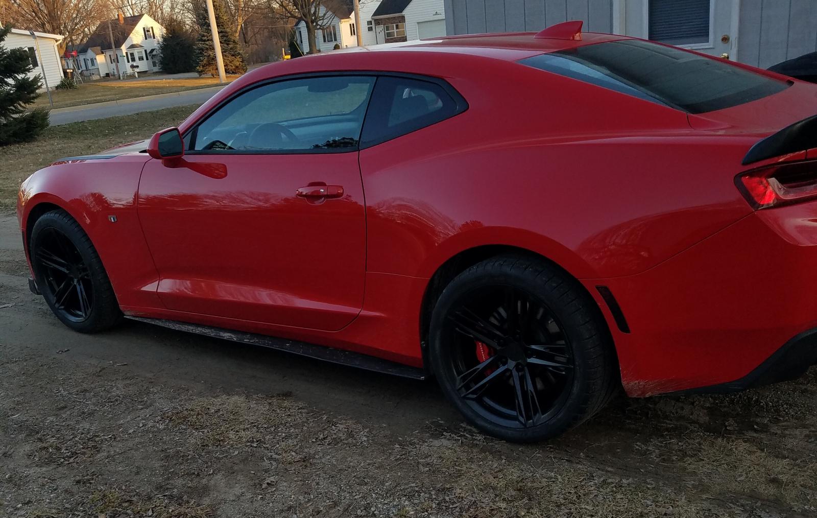

I got 325/30/19s right now and they fit fine. I couldn't imagine going much wider but anything is possible I'm sure! The only pic I was able to get [it's dark and it's not clean:( ] before winter came back in full force!
Mrc, non lowered
Which Tire? Weird how that 325 looks like it is too big for a 11" wheel. Sidewall looks like it is spilling over.... could just be the pic.
Here you go. .
LOVE IT. Look at that nice squared sidewall.
