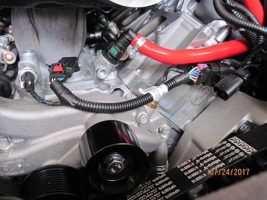

It's in the top pic.......take it...lol. I'll dig it out tomorrow, PM you for your address again.

I just realized, you should have the OEM hose on there, with a 90 degree fitting.
Same as first pic. Were are you tapping in for case vent? (under the intake manifold, front, left side?) You don't need the 90.
