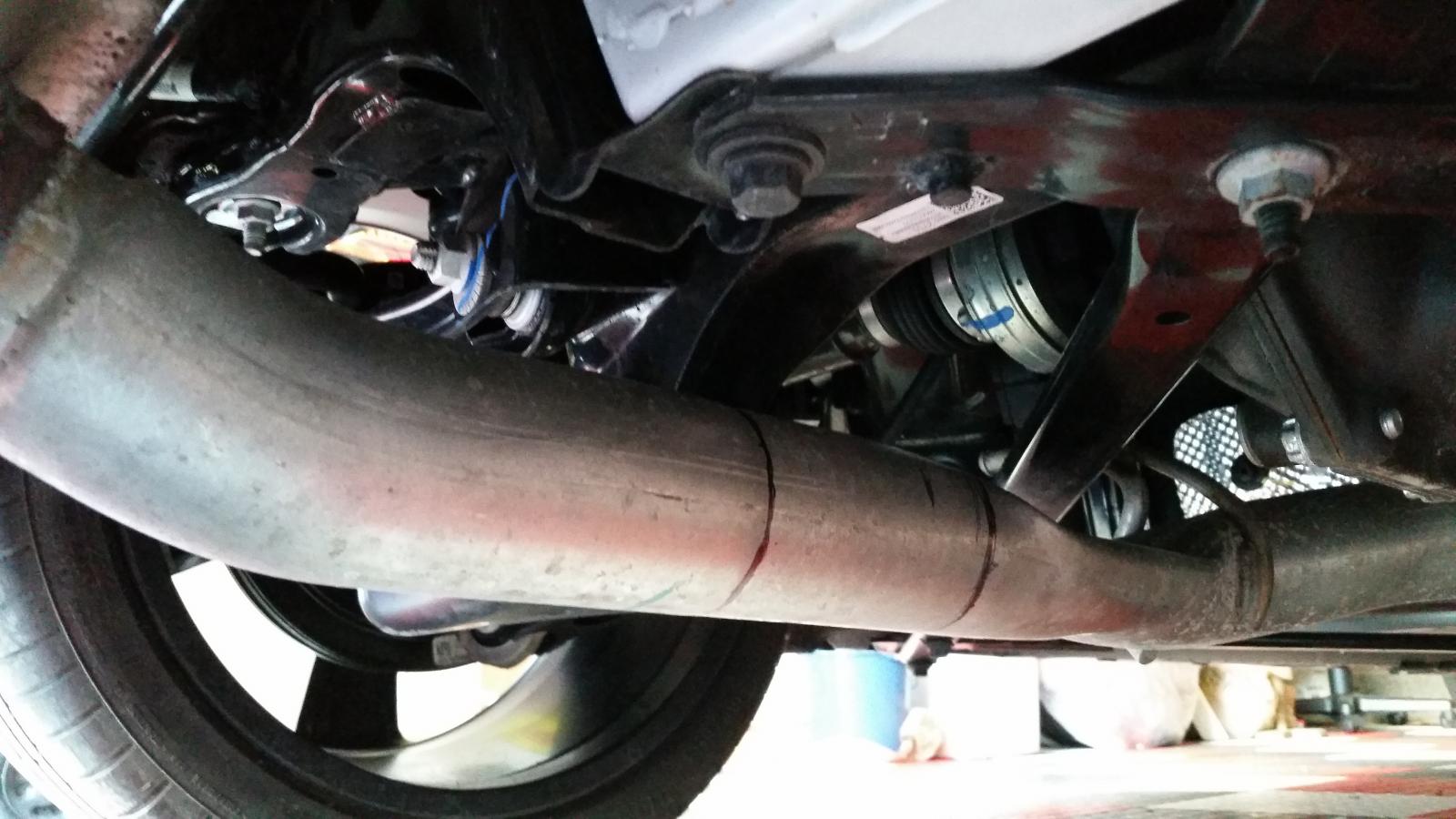

We just installed the MRT v. 2 Axle Backs on my V6 'vert....nothing but trouble getting the pipes pre-muffler to not hit those cross-braces. It's still knocking somewhere mid-stream by the resonators when the system is cold or if I hit some big bumps (not difficult to do here in mid-Michigan).
Back on the lift it goes...
Update - got it back on the lift today and it's confirmed that the resonator is hitting the cross bars. We tightened up the clamps, winched up the rubber hangers a bit, and we'll see how it goes.

I have had similar situations on 4th gens and I used to use the heat wrap they sell for headers to pad the spot that was hitting. Especially if it is just on big bumps.

I just looked at MRT and they cut in front of the hangers on the V2 on their website. There is a flat spot just rear of the hangers, and then a straight section of round just behind that where most axle-backs are cut. It looks like MRT tried to get rid of the flat pipe too by replacing it and the hanger. They probably also cut out your AFM valves if you have NPP. The problem is, the flat pipe is in there to clear the braces on the convertible.

The cut point for the MRT is all the way to the right, past the flat section. I doubt that can ever be installed on a convertible without some contact. I would seriously look a that header wrap I suggested earlier. Wrap it around the MRT right where it goes over the braces. At least it will keep it from banging.
