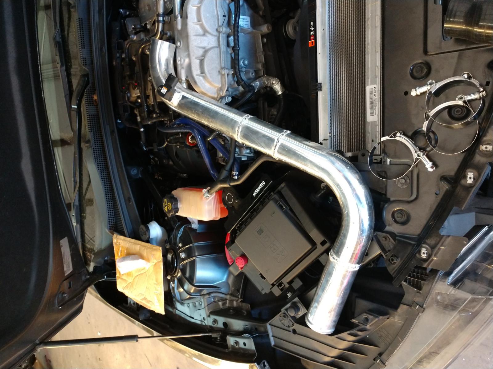

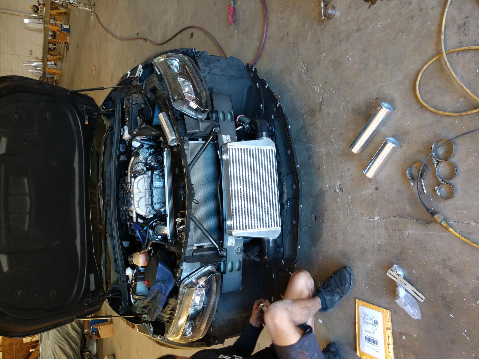

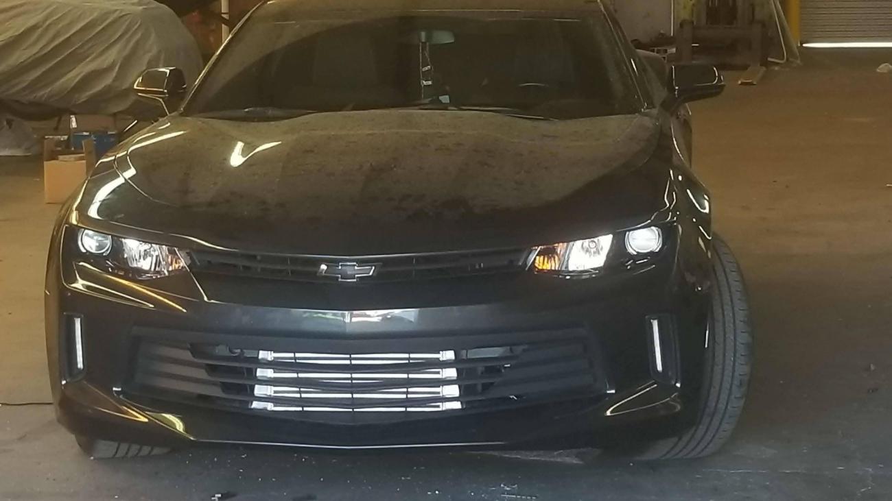

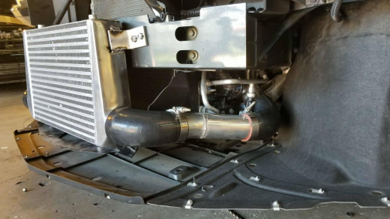

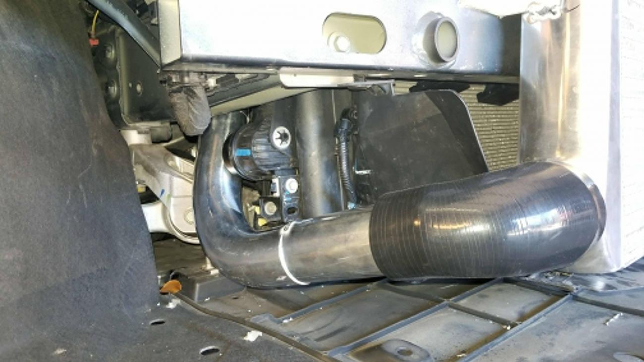

Finally got the job done, end cost was 550 bucks. Some bumper trimming had to be done but could be avoided if you pick a different intercooler size. The stock intercooler was left in place and the universal piping snaked around it.

First I would get am intercooler with slightly different dimensions, and honestly if you don't mind using a few more couplers the. U wouldn't need a fabricator

I'd love to know the dimensions of that other person's intercooler. if you mount directly under the crash bar you could get away with a slightly wider and thicker IC, it would just have to be shorter. As far as parts I used 5 couplers, I could have used 4 just on the end attachments but that would require removing the old IC to make room on the hot side. Just be very careful with the AC lines they are weak as heck.
