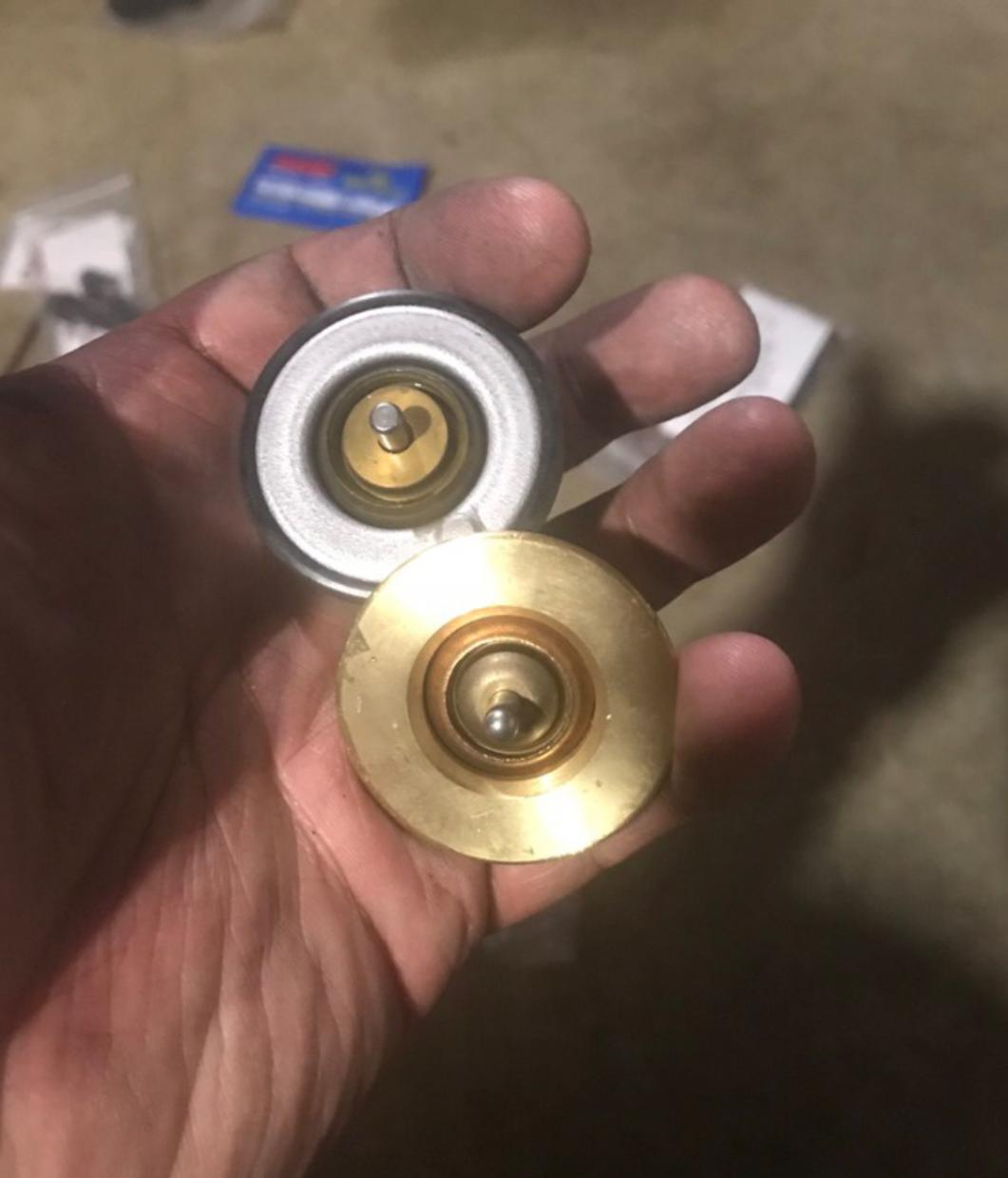

Hey when your installing can you check if the thermostat they provided you looks like the stock one with the seal on the front? I got one different than the stock type and been have a p0128 code ever since even after 2 canned tune revisions... the Whipple rep that posted on here when I posted the question swears it’s the right one.

Pic of thermostat
