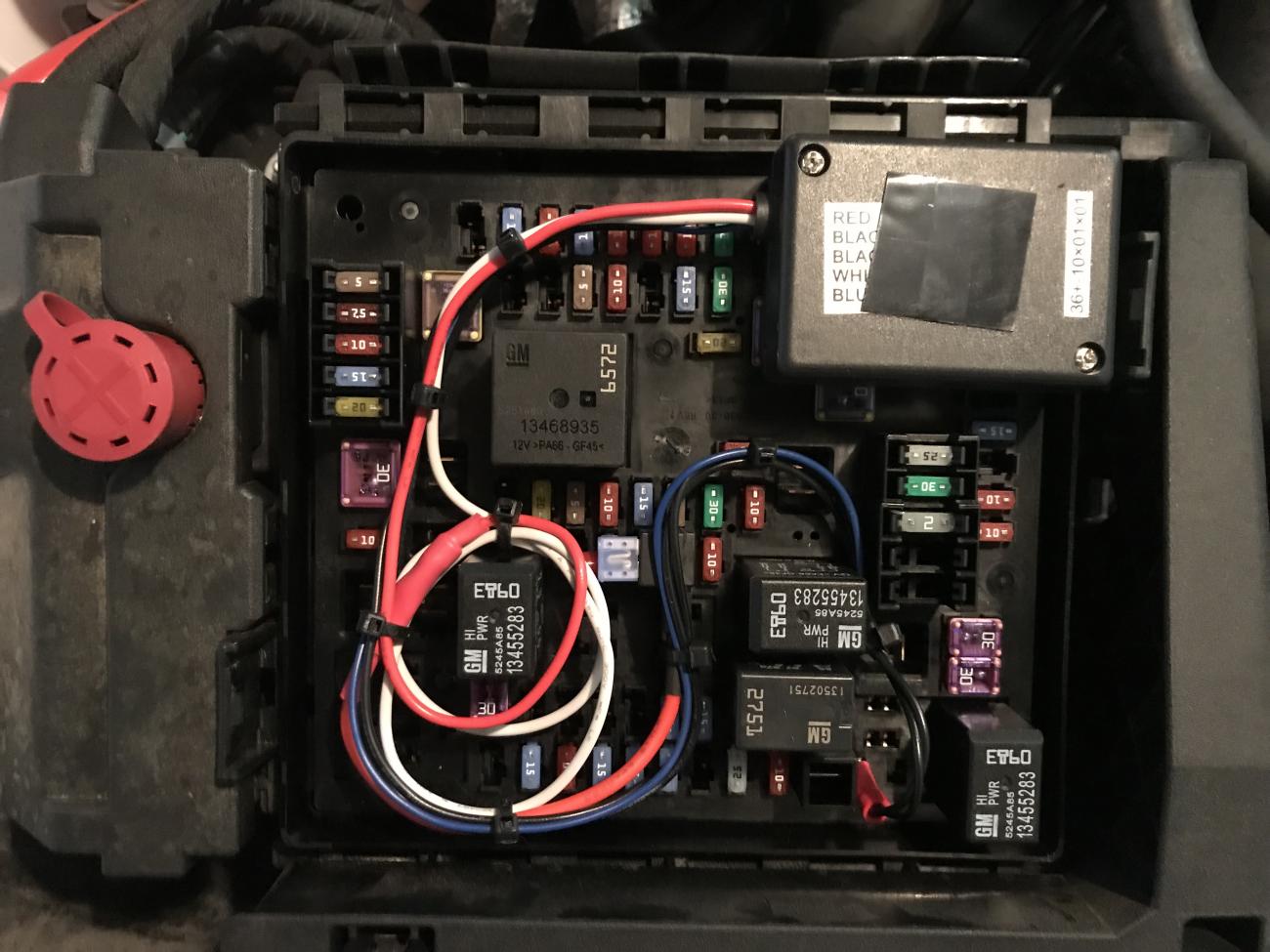

Well I installed the mild to wild controller anyway. If the only benefit is that it keeps the valves open all the time, even while cruising, that will be fine. I’ll give it a try! Here’s how I installed it into the fuse block without having to notch the cover.

What'd you use to stick into that ground slot? I'm having a hard time finding something that'll stay in there.
Rich
If I'm looking at the right picture, the ground slot looks to be fuse (can't remember the exact type) slot. You can cut apart an old fuse and use the blade to plug in. Just be sure to solder or crimp connect the wire to the old fuse blade.
Rich
I used a red open crimp lug and cut half of the fork off and plugged it into the ground socket
It's not an unused fuse slot (female). It's an unused slot for one of the relay looking square cubes. The only metal in there is on the very bottom. There's nothing on the sides to make contact with a fuse prong.
I tried a yellow blade terminal but it's not working.
I’m out of town today so I’ll get a better picture for you tomorrow night
