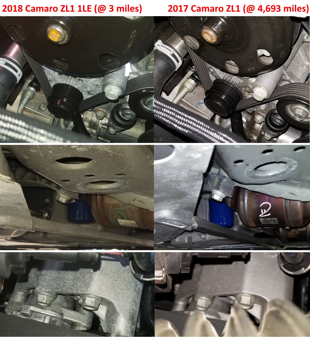

I'm convinced you guys are making an issue out of nothing with this one...this is not a design flaw...it's raw, unfinished aluminum. You may not like it, but it's what it does.
I'm glad you don't care about sub-standard NEW Parts, but when I spend $80K USD I expect all parts to be in NEW UN-CORRODED Condition.
Aluminum Corrodes Only when EXPOSED TO A CORROSIVE ENVIRONMENT.
I've worked on Marine Engines that are used in Salt Water that DO NOT HAVE THE CORROSION DEMONSTRATED ON NEW DELIVERED GEN6 CARS because THE MARINE ENGINES USE THE CORRECT FINISHES.
GM IS BEING CHEAP...PERIOD!

Maybe...maybe not. There's no period there you can place definitively...you're just upset.
I also work in the marine Industry; I've had my master-level merchant mariner credential for over 6 years, now...Been sailing ships with tiny diesels, turbo-Fiat cats, Mercury outboards, etc...at the helm, in the engine room and/or bilges...the marine world is a totally different animal, and equipment is far better maintained for obvious reasons. You can't expect a car manufacturer to build a car like a boat.
Depending on the purity of aluminum, it will patina and corrode readily when exposed to nothing more than moisture and the air itself. A "corrosive environment" is not required. This is not aircraft-grade 6061 we're talking about. That'd be ridiculous. Perhaps GM could look at the alloys they use? But then, like I said - so would everyone else...this is not a "GM" issue.
And it's not that I don't care about substandard parts. Please don't put words in my mouth...I just don't find an issue with a patina on the finish on a non-aesthetic part when it doesn't affect the structure or function at all. Pitting? Flaking? Yes...that's not right. But 90% of what people are bringing up in here is not that.
And furthermore, I realize that this oxide will occur in time no matter what you do. So while I get the "I want it shiny and new" argument...it's either now or later - and these cars are so damn fun to drive, I just don't feel like waiting!

Chemistry 101.
Aluminium corrosion resistance is very good in untreated aluminium. Untreated aluminium has very good corrosion resistance in most environments. This is primarily because aluminium spontaneously forms a thin but effective oxide layer that prevents further oxidation.
Aluminium oxide is impermeable and, unlike the oxide layers on many other metals, it adheres strongly to the parent metal. If damaged mechanically, aluminium’s oxide layer repairs itself immediately.
This oxide layer is one of the main reasons for aluminium’s good corrosion properties. The layer is stable in the general pH range 4 – 9.

These pictures are comparing the "brand new" 2018 ZL1 1LE to my 1 year old ZL1. (I absolutely did not retouch either photo, both are exactly as they were taken. I even purposely left the dust on my car to show that I didn't attempt to clean it in any way.)
