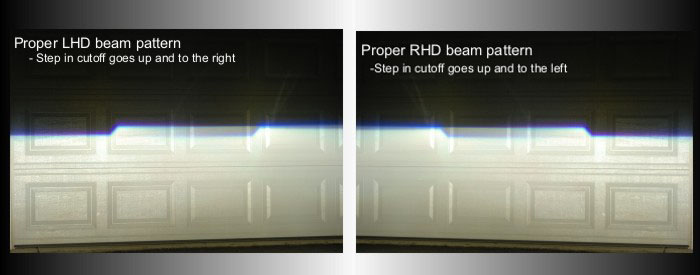

Anyone here had to have their headlights adjusted? I think mine are aimed too high from the factory. I've been flashed by other drivers 3 times in 4000 miles. I've owned about 8 other cars with HID headlights and never been flashed. It also seems to me that the cutoff along the right side actually goes up...rather than down as the light gets further out. Very different cutoff pattern than our '16 BMW with HIDs.
I assume they are fairly easy to adjust. I supposed I'll just have dealer check at next oil change (in about a month).

+1 Kudos for Chevy doing a good job with the headlights!
This post says non-RS so not sure if relevant... but a google search for "camaro6 headlight adjustment" came up with this and about a half-dozen other threads.
http://www.camaro6.com/forums/showthread.php?t=471781
Here are the adjustment screws for the HID headlight assy.

Yeah it seems to be a hit or miss with the factory headlight alignment. Before buying my Camaro I saw multiple complaints here of owners getting flashed with just the low beams on. I was prepared to align them myself but so far I haven't been flashed once.
