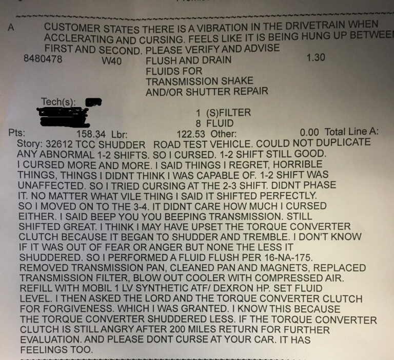

New attempt at remedy for shudder...
I was sent this copy today of a recent service request and subsequent tech response for the shudder issue. I was also told it was in a new Camaro.
I'm pretty sure the service writer was setting him up... but he responded in kind.
