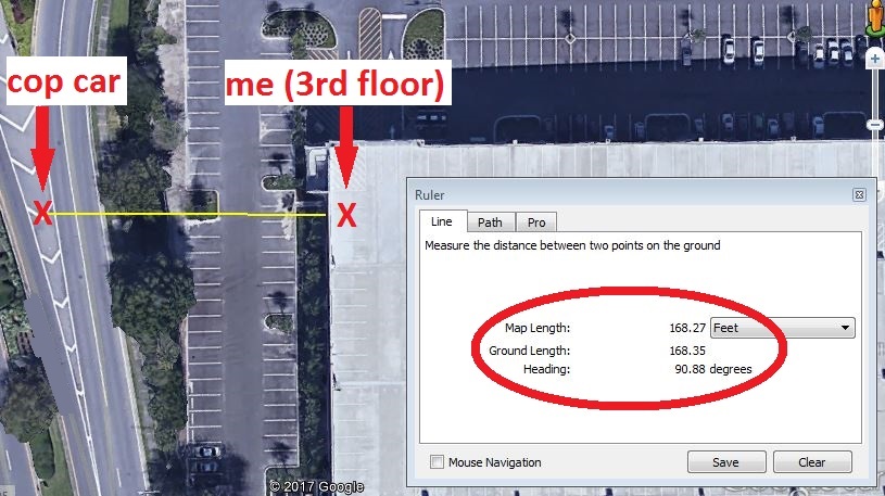

Originally Posted by camaromike77 View Post
This is EXACTLY what I was told when I took mine in for this issue. Police transmitter(s) / interference.
I parked my 2017 2SS at work today in the usual spot in the employee garage (+/- a few spaces), and found out that the fob was dead. It worked just fine to unlock and start the car about 25 minutes prior, when I made a stop on the way to work. I had already locked the doors with the exterior handle buttons, but my OCD-based "hit the lock button on the fob a couple of times whilst walking away to hear it honk, just to really super duper make sure it's locked" did nothing. I couldn't unlock the doors or trunk with any fob or handle button method. I said screw it and headed into the office. Can't get in now, can't get in at 5, same difference.
camaromike77's post is interesting because I recall seeing a police car parked about 50 yards away, with full lights going, behind a disabled car on the adjacent street.
Let's see what happens at 5...
Mark
EDIT: Map added below. Police car was 56 yards away.
