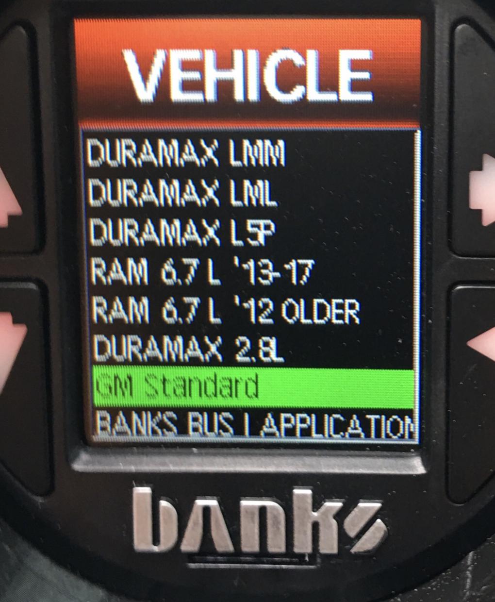

Ok I can see the Ethanol Content fluctuating around 9.4 to 9.8 with HP Tuners. However I can not find the PID for E content in the IDash Supergauge.
The 2019 Zl1 has an E92A ECM.....Anyone running a IDash on a 2019 and monitoring E ?

I don’t have a 2019 or ZL1 and I don’t believe your problem is MY specific. Did you select GM standard for the vehicle?

Sigh....That was the issue! When the I Dash booted the first time I must have fat fingered the first selection without knowing.
I did a factory reset and started from the beginning and as you say selected GM Standard. Then went through the PIDs and low and behold it is in the correct PID menu!
Thanks for setting me straight!
