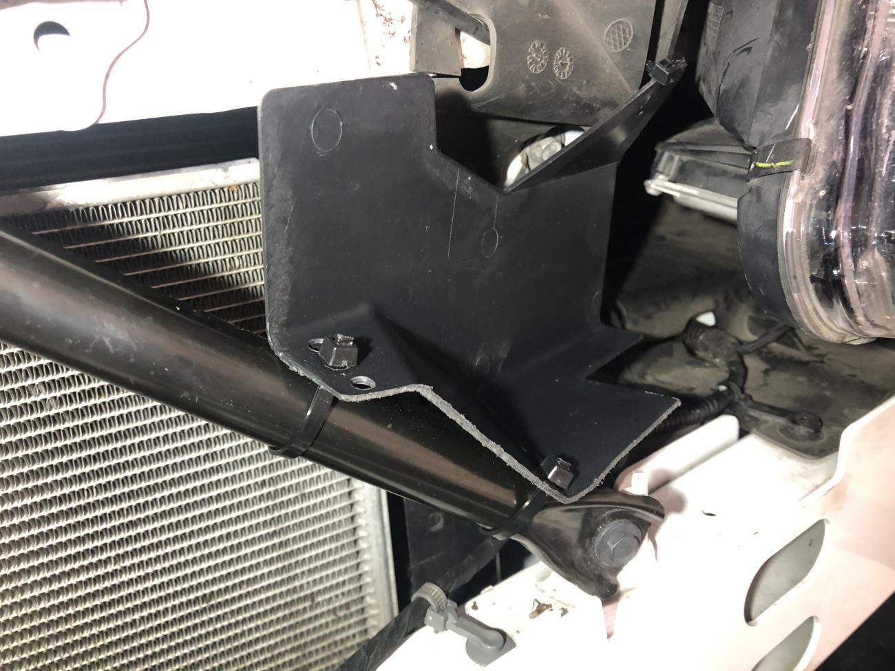

Poor Man’s grill air scoop
I had the front clip off for a new grill and decided to take a look at doing the Velosa intake scoop. I removed the plastic blocking piece and modified it to work as an air deflector, not so much a scoop. I modified the blocking piece by cutting the long portion off, drilling some holes, and using zip ties on the black brace. First pic is before I cut the piece for reference. Second pic is finished product. Took all of 15 minutes complete! I don’t know if it will make a difference or not but I figured what the hell, might as well try it.

I did the "mini mouth" mod too. Except I just took the one body rivet off the inner portion and rolled it back and rested it against the back side of the grille.
The butt-o-meter didn't notice a difference, but I do know the ram air effect is real and does boost HP.
$170. for a .25 cent piece of plastic seems a little ridiculous to me.
One of these days I'll pull the fascia and design something out of sheet metal or something.
I'd recommend putting it at a 45* angle to funnel it towards the opening.
Think of taking a hose and squirting it at a plate. The water will bounce everywhere.
Since air behaves like a fluid, that is what is happening right now as you drive down the road.

Looks like it’s about a 30 degree angle towards the intake right now. I’ll try to get it more at 45 if I can.

I was able to move the left end out toward the grill and added a zip tie at the upper right. It’s pretty close to 45 degrees and is more direct into the air box.

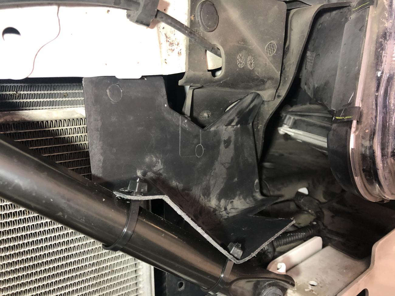

So after looking at it I realized that my piece was too low below the upper grill opening to have any affect. I added more of a backer ant top piece so it can capture directly behind the grill opening. It’s about a 30 degree angle towards the air intake.

The one thing I will tell you is to watch for Hydrolocking your motor in deep water or heavy rain. I saw many stalled cars last May in Naples....they drowned themselves out.
Those deflectors are there for a reason.

With a Roto you just drill a bigger drain hole.
