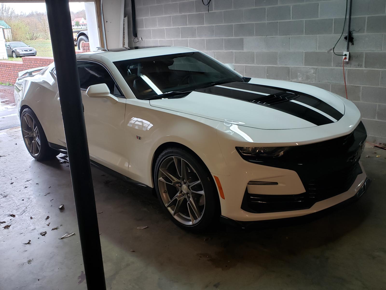

stock wheels with 20 mm spacer. Rember you will most likley have to cut the excess non theared part off the stock stud
Kerry is offline   Reply With Quote

another

Posts: 834
I think this it the firehawk 500 i think it was in the 285 useing the 20mil spacer. Then i went to fk500 falken and its is a wider tire in the same size and I had to go to the 15 mil spacer. Only reason I went with the fk was because the firehawk was just a narrow tire but to my surpiise the fk hooks better and is so much smoother a tire I really like.
Nope trhis is the lxxina 295 with a 20 or 15 spacer but its too tall ot make work

Posts: 834
This is current fk falken 500 now I been running a while. This is the rear as far out as I can go with out rubbing the fenderI got a uphill dip with and hump that i run up and if it makes it past that dip hump at 70 its not gonna rub ha! Its just a tall tire and can move it out futher with a shorter tire and i think looks better but. This wheel sticks out futher than any og the others on the car for what ever reason. I run a extra 3mm spacer on the passenger side just to make it closer to the same weired. So their not all the same
