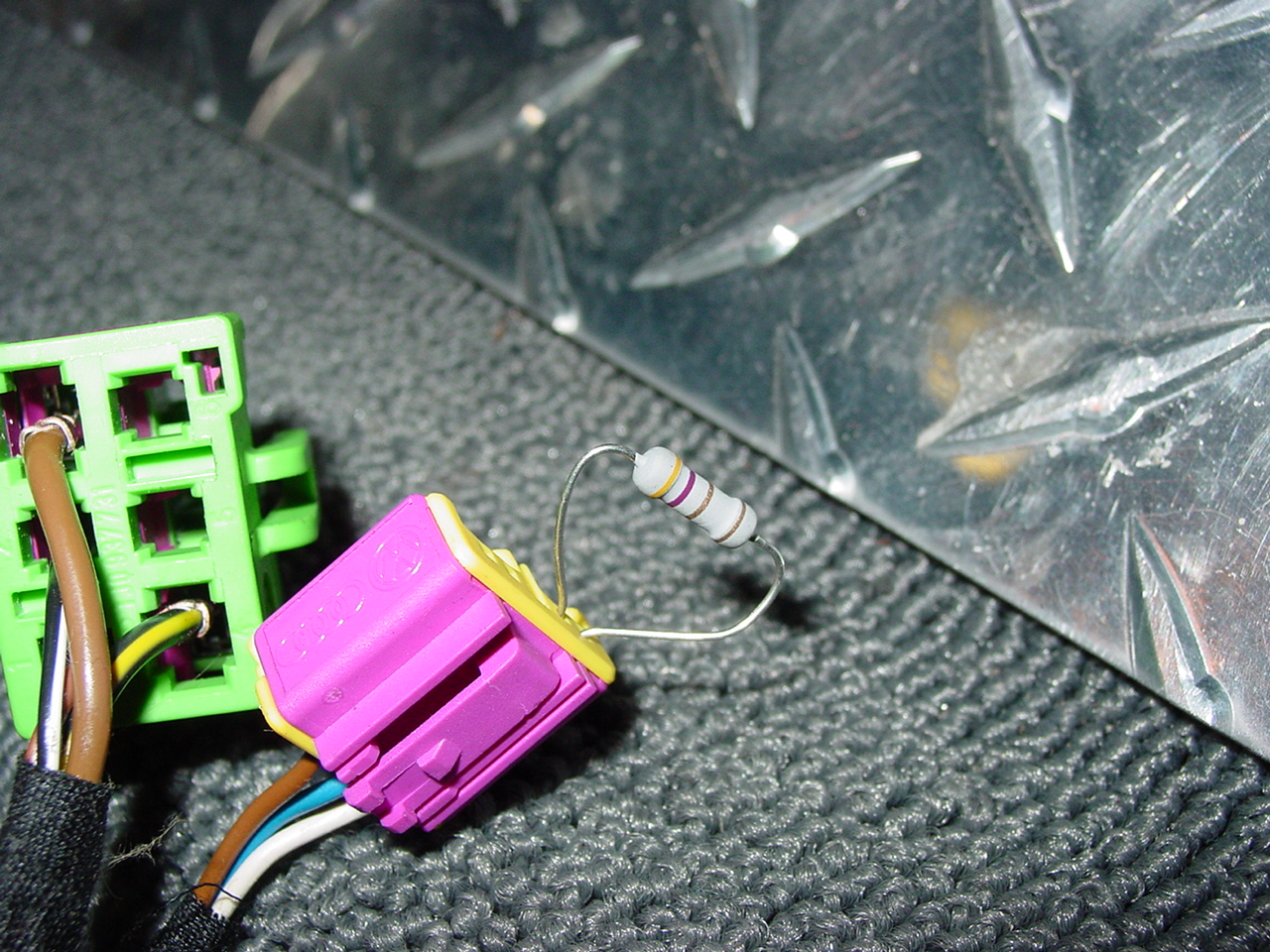

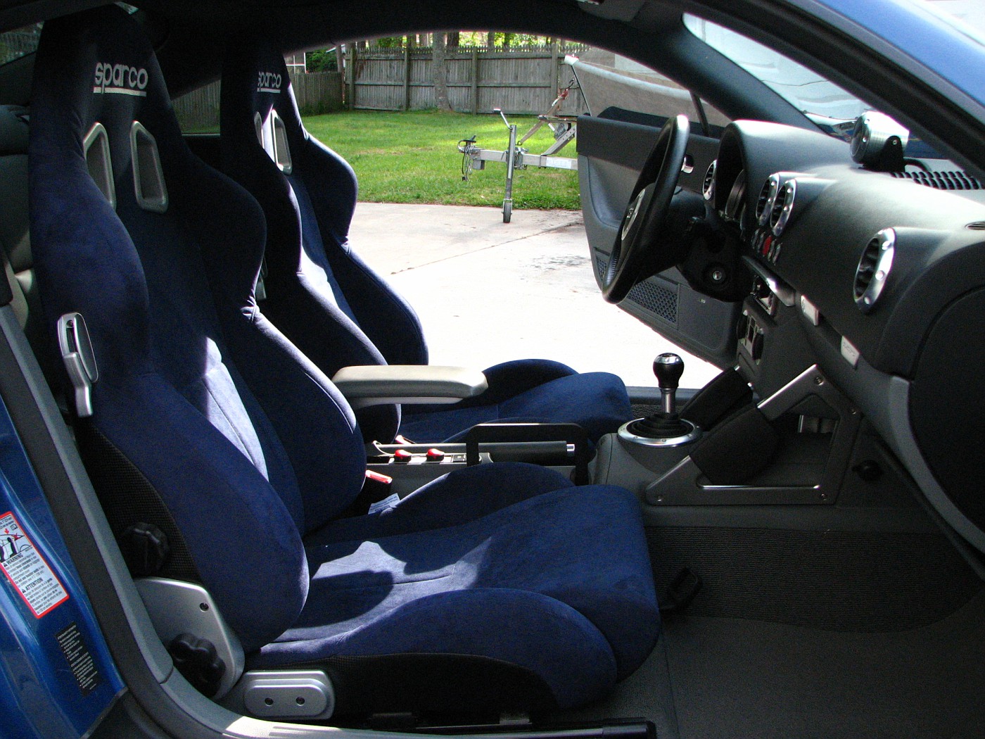

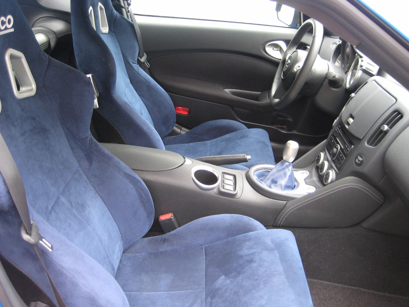

On the Sparco question, in the old days a simple resistor would defeat the airbag warning and make the car think the bags were still there. Unfortunately, Newer cars with pressure sensors in the Passenger seat make things a bit more complicated. Without figuring that out, your passenger front airbag is not active...
A simple remove/replace should not be a problem. Just DO NOT turn the car on when the harness is unplugged
My old TT was easy due to no pressure sensor:
I never did get the 370Z worked out:
