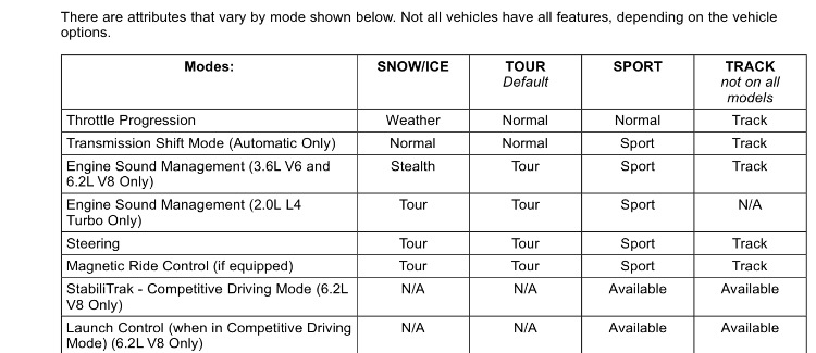

3. Does anyone know what EXACTLY changes with each drive mode?

3). This is actually listed in your owners manual in Drive Mode -- It's a table that's also been posted on here a couple times. Now, as for the absolute specifics of what damping in Track vs Sport means, or the percentages throttle application translated to engine response. I can't answer.

3) Depending on whether you have MRC, Auto trans, and NPP, the drive modes change throttle response and steering wheel effort at the minimum. If you have an auto, then shift points/firmness would change. NPP, then exhaust valves....MRC, then suspension setting.
I don't remember if traction control level is changed between the modes but maybe someone else can confirm that.

Check the big grid in the owners manual. It has every mode and what it affects....
Oh you mean this vast source of knowledge and information?
