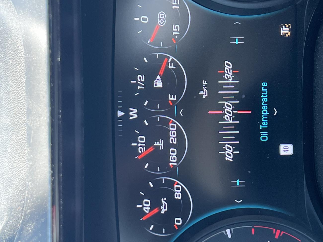

Mine is 38.9
Engine oil temp 129F. Should be measured at operating temp ~210F to get some consistency with the group. It will drop to 29-30psi.

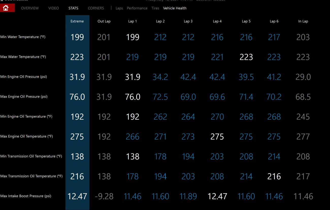

I see 29-30 psi at hot idle (~210F with either 0w-40 or 15w-50) in normal driving and on the track (15w-50) I see this in July 100F+ ambient. The min values should include idle time ("in-lap") before I shut down:
I see just a hair below 40 at full operating temp -210 for the oil temp. Others with 23s are in the same range at full operating temp. It’s seems that the 2022 and 2023 (not sure about 2021) have a higher target idle pressure.

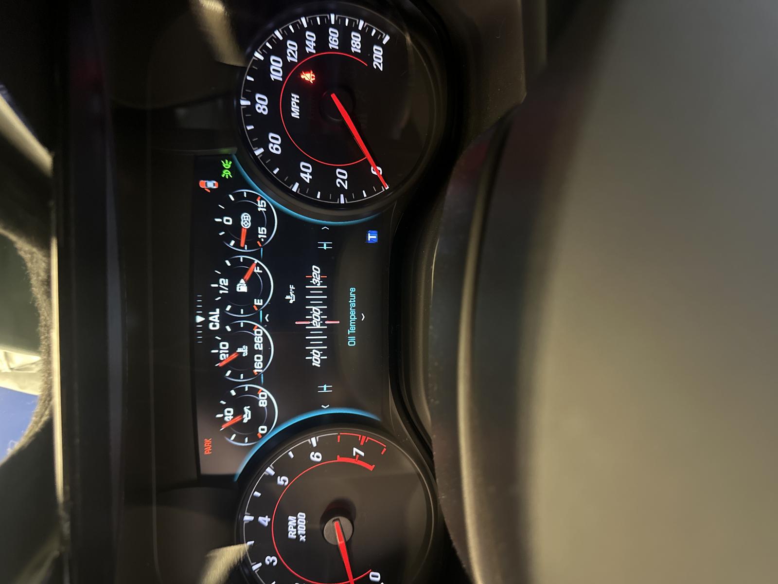

Update:
0W-40 has been put in the car; pressure seems to be about the same, maybe like 1-2 PSI higher max.
Warm idle from normal driving conditions (oil temperature at 200 degrees) is dead on 30 PSI.
Warm idle from driving under LOAD (doing a couple hard pulls and idling right after) seems to be about 28.
Does this line up with others’ experiences? I feel like I shouldn’t be worried since I just had the pump replaced under warranty, but at the same time I wish it would just stay pegged at 30 PSI idle regardless of the temperature.

I would say this is dead accurate with my conditions on my 2018 with 17k miles and a stock pump. 28-30 hot idle. Maybe a tad higher in cooler weather and obviously a bit higher under load
