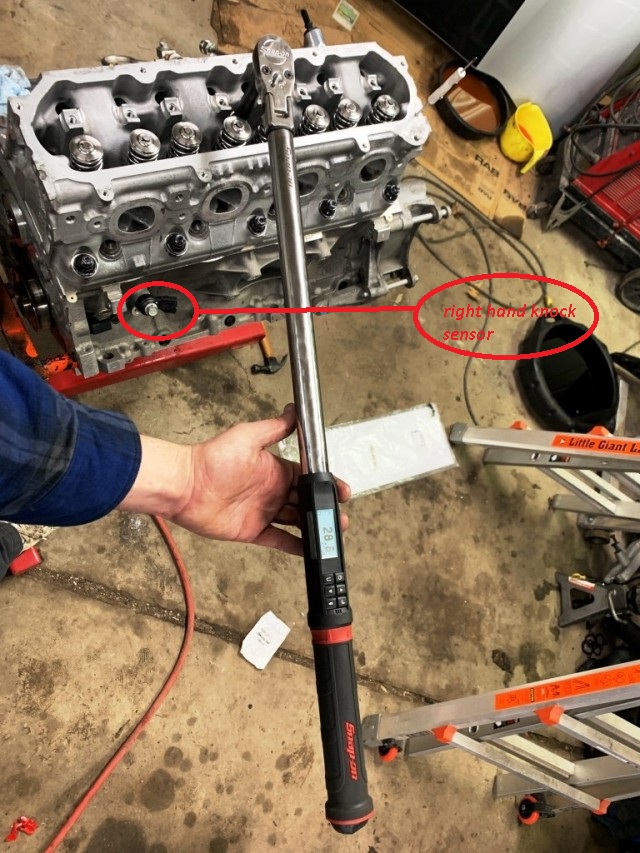

After I dropped everything off, I got to wondering about the location of the knock sensors. I’m pretty sure I removed all sensors from the block – all I remember is the crank position sensor in the back and the cam sensor on the front cover. I’m guessing the sensors are in either the heads or on the valley cover?
the knock sensors are on the left and right sides of the cylinder block
the drivers side is protected by a little heat shield
see image below. the other side is directly opposite.
good luck with your build

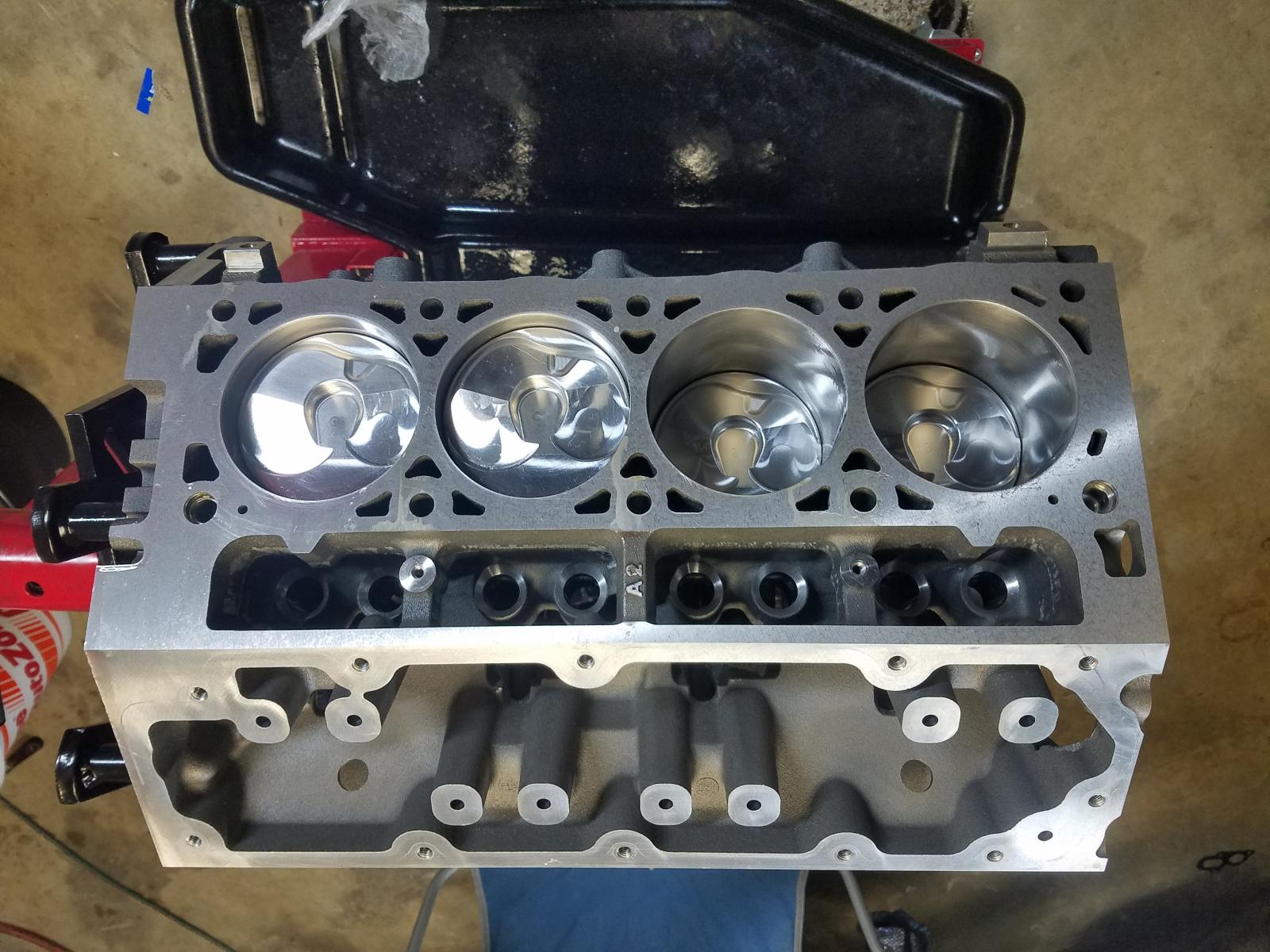

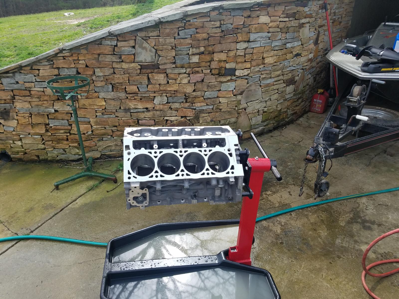

My winter project is turning into a spring project, but I’m finally back in business! Got my motor back from the machine shop last week. She’s balanced and honed, heads and block are surfaced, new springs, retainers, and keepers are installed in the heads.
I spent all day Saturday making sure everything was surgically clean. Yesterday I stuffed her full of CompStar rods with Diamond pistons from GPI along with some ARP main studs.
