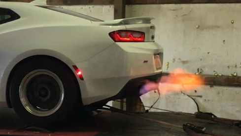

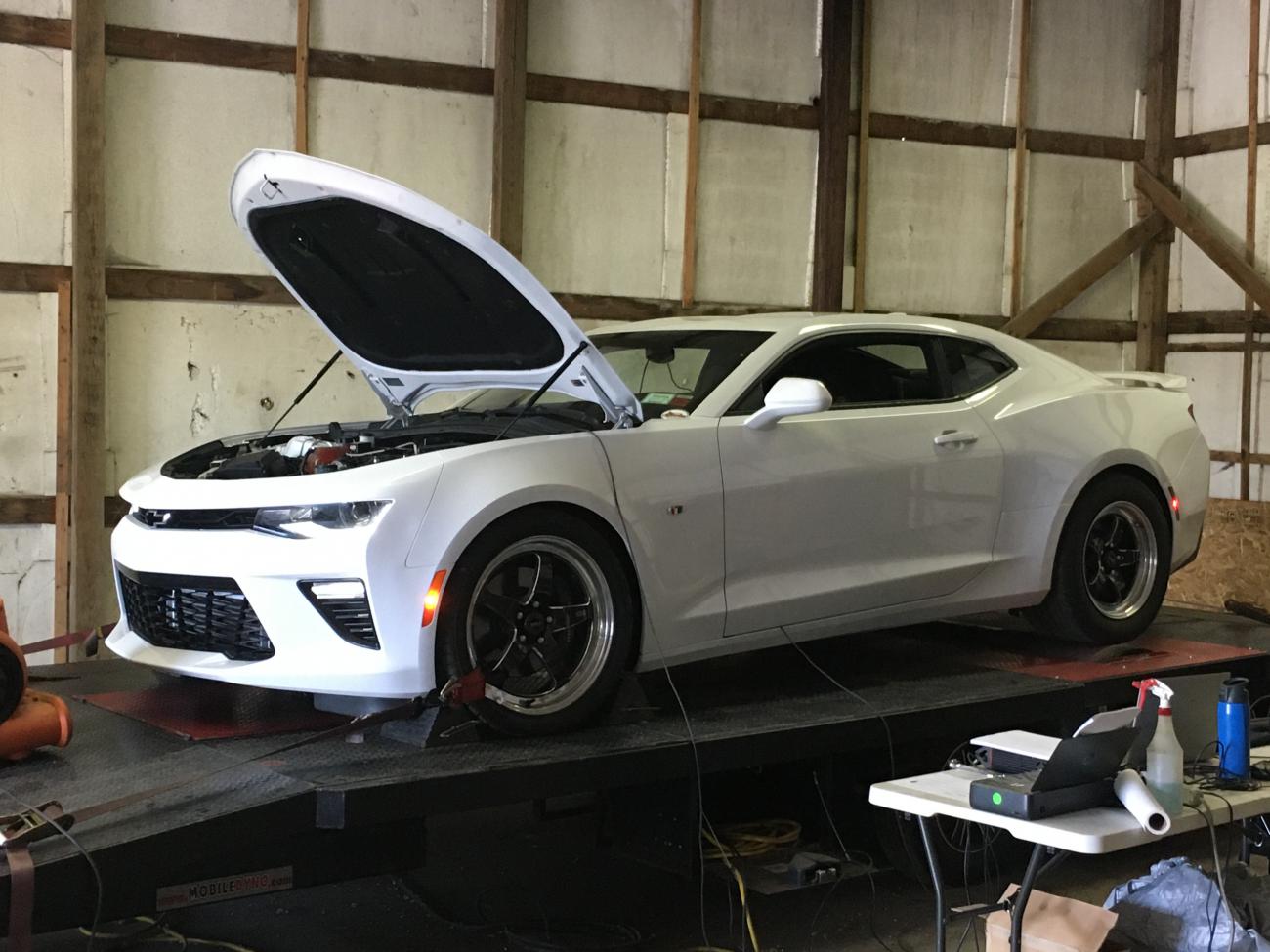

Dyno went well yesterday. It was hot and humid but the Car is back up to 15 psi and made 800 hp and 900 tq again. Solid baseline to start testing and playing with.
