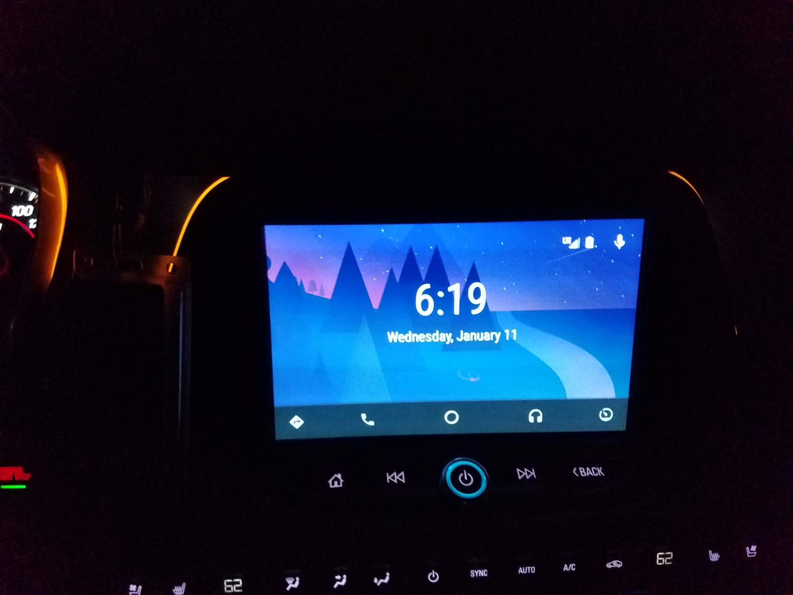

I just got my 2017 and I csnt get anything except a black screen with Google maps and a few icons at the bottom. One for phone and music. I have a s7 edge. Im completely lost.
Take the car to your local cell provider store and try another phone/cable. Sounds like something is wrong. Never seen a black screen with maps with mine.

I'll check with a different phone cord although this one's only about 4 months old but I'll take your advice and go buy a new one is there any specific place I should go as in a cellular phone company or just any store that sells cords forgive me for my ignorance on this.
This is all that shows up on the display
What happens when you press the icons where you see the head phones etc?

Phone is on charging mode. What should it be put on? When I press head phone icon Google music shows up. I'm not educated on this i guess
Try this video. It looks like Android Auto is working from the screen you posted.
https://www.google.com/url?sa=t&rct=...43423383,d.amc
Come back with any specific questions and will try to answer.
