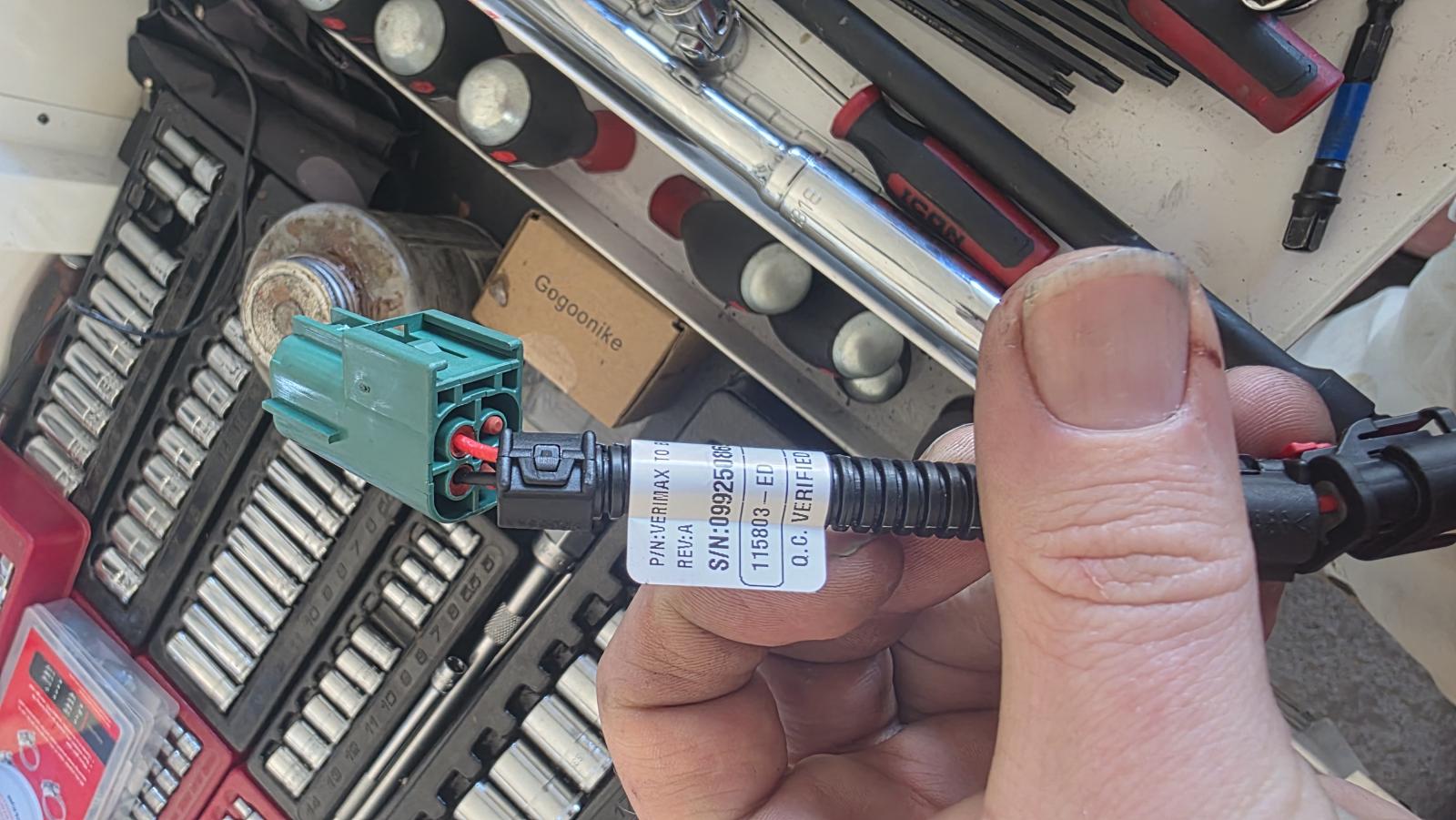

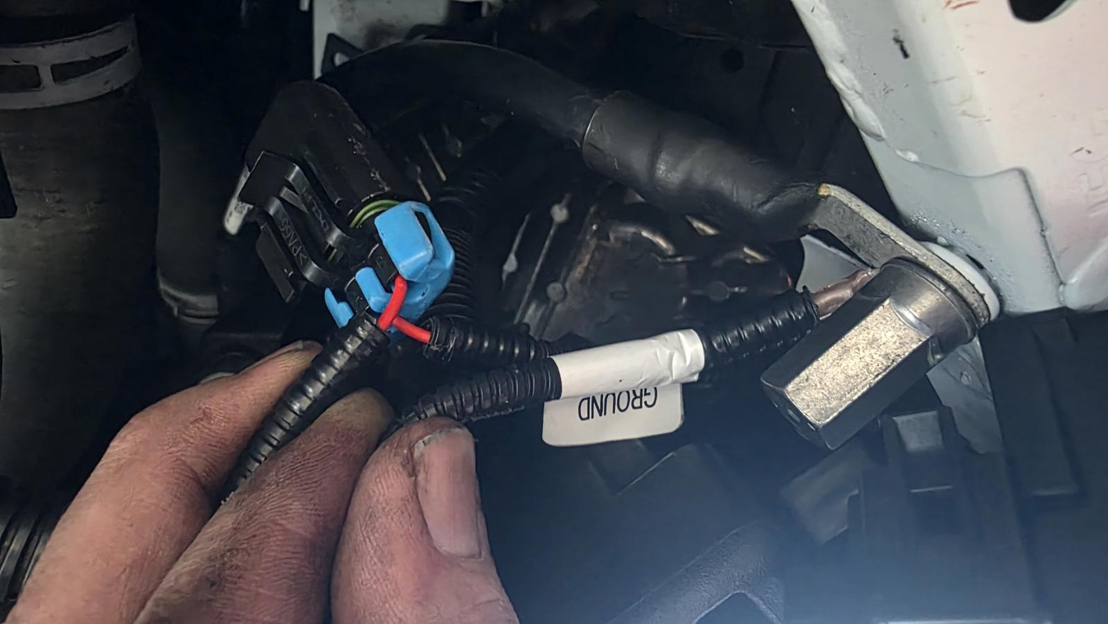

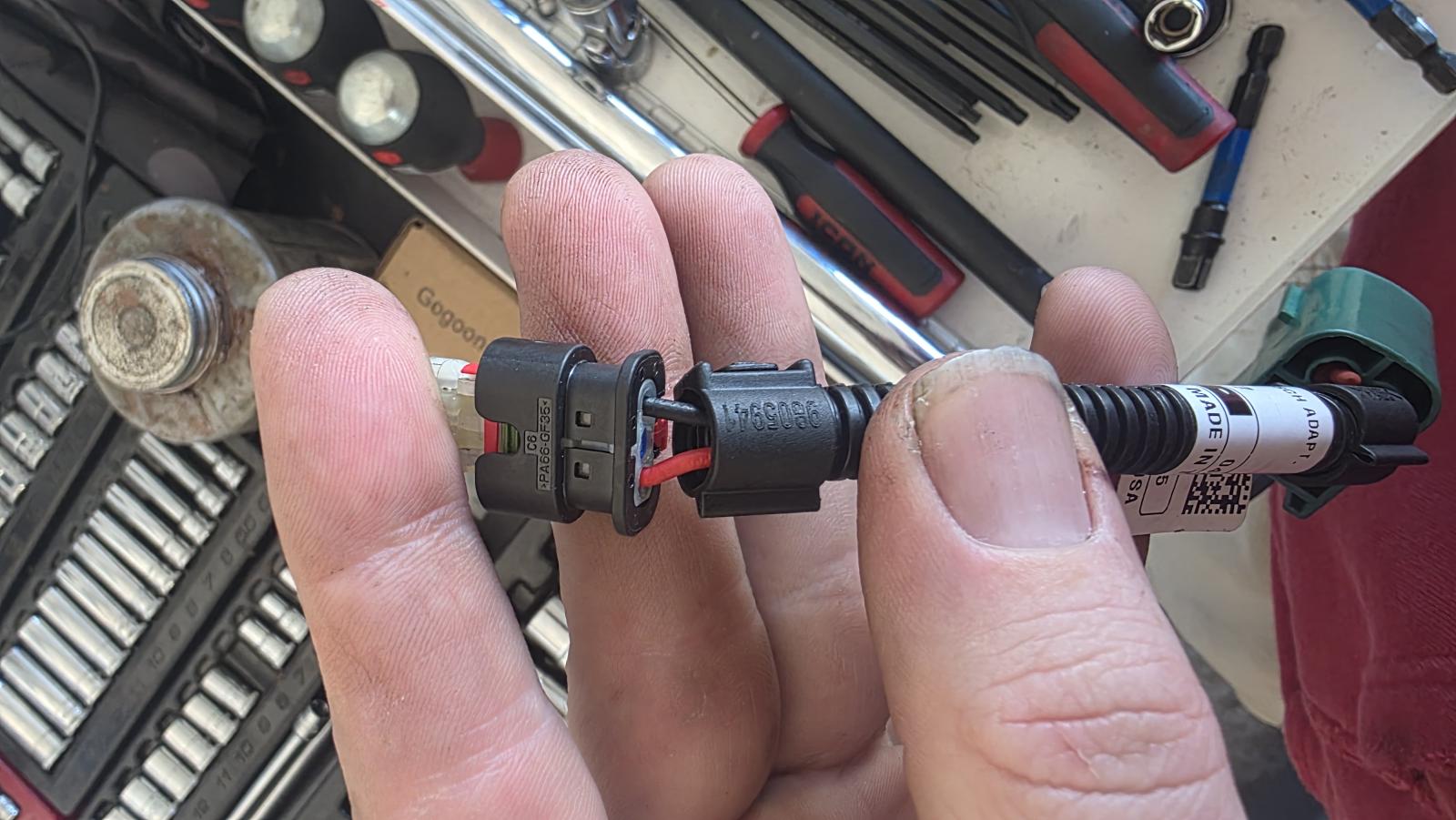

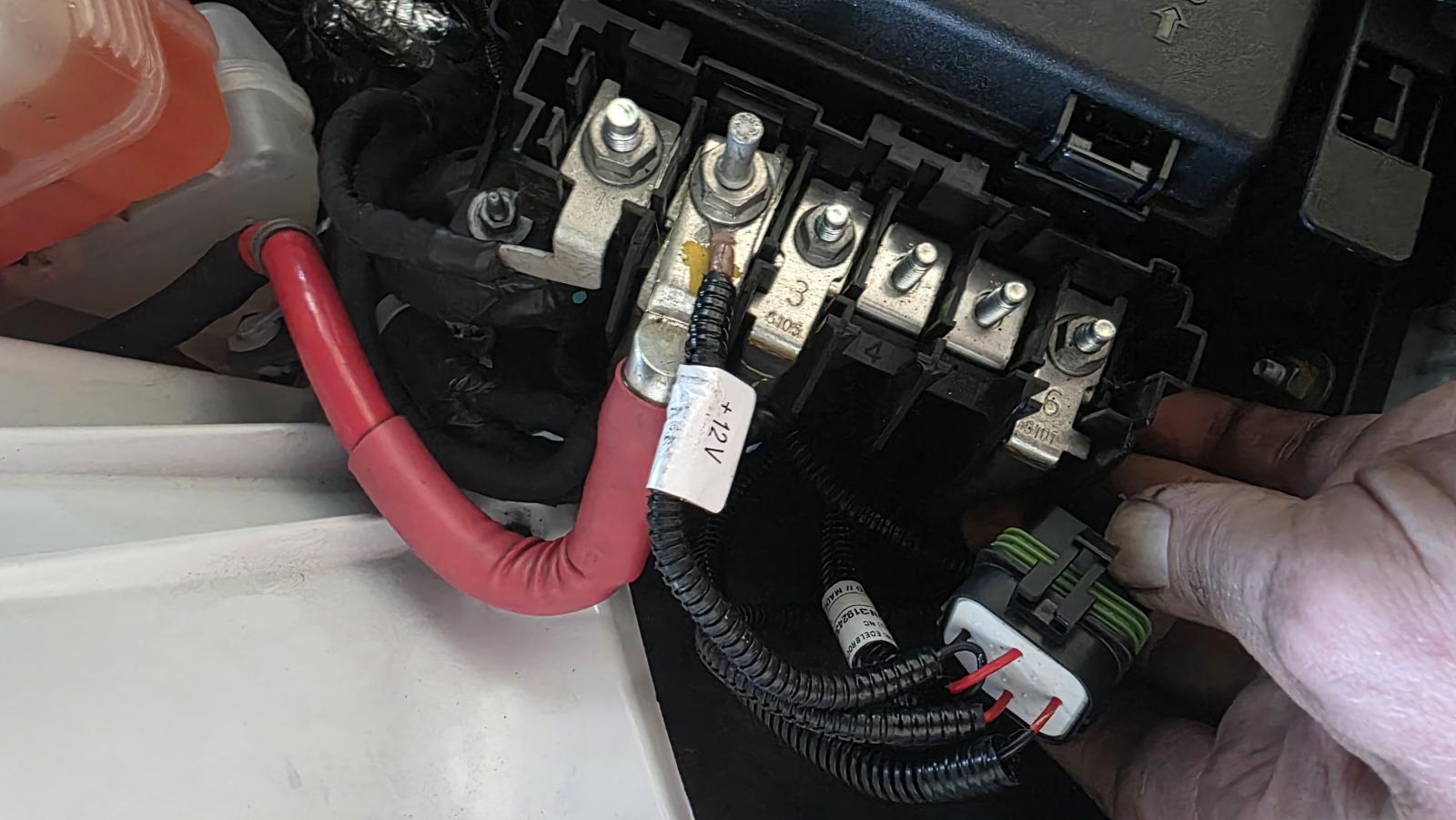

Well.. getting closer. Everything is installed, base tune flashed and she started. Couple small snags before I can drive it through.
The provided Bosch intercooler pump will not turn on. I installed the Edelbrock provided harness as they instructed. There is 12v at the pump plug, however..I am somewhat concerned about the polarity, given the way they made the harness.
The wires colors are red to ground and black to positive. The relay stays latched (pulled in) the instant I plug it into the harness, regardless of ignition position. Naturally, Edelbrock isn't open on the weekend (when everyone actually does this kind of work) so I will have to reach out tomorrow. There's also a map/baro sensor code being thrown...but I'm hopeful that's just a calibration thing.
Any body have issues like this with these blower kit harnesses?
Enslaved is offline   Reply With Quote
Old 09-21-2025, 11:50 AM   #25
Enslaved
Drives: Camaro SS 1LE
Join Date: Aug 2025
Location: New York
Posts: 59
Quick update. Just got done staring at pictures online and through the manual.
The wire labels that Edelbrock installed were placed on there incorrectly. Effectively inverting positive and negative.
Turns out - when you have the polarity correct - things actually work as intended. That was a pretty rediculous, but potentially dangerous/expensive flaw.
Pump turns on now. Now I question every single thing that Edelbrock did on the two provided harnesses. Naturally, they dont have published wiring diagrams. Really hoping nothing has been damaged.

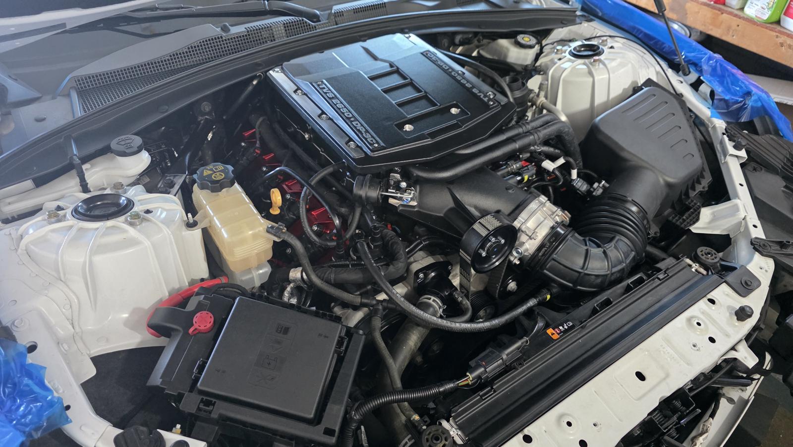

His intake tube is so impeccably lush wet black, though, I'm in envy
