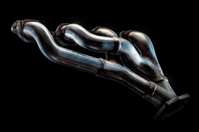

Replacing the crushed section does NOTHING for HP and sound.
Our cars have OEM tri-Y headers from the factory, thats why they sound so good.
Old 11-26-2018, 07:34 AM   #20
avalonandl
avalonandl's Avatar
Drives: 2019 ZL-1
Join Date: Feb 2009
Posts: 2,018
OEM header

Originally Posted by avalonandl View Post
OEM header
I'm assuming the only reason GM went through the hassle of designing a separate header for the LT1 Camaro vs corvette is because of clearance issues. I know there are a lot of differences in the camaro vs corvette tune, just seems like they could have kept them the same and saved a lot of money.
