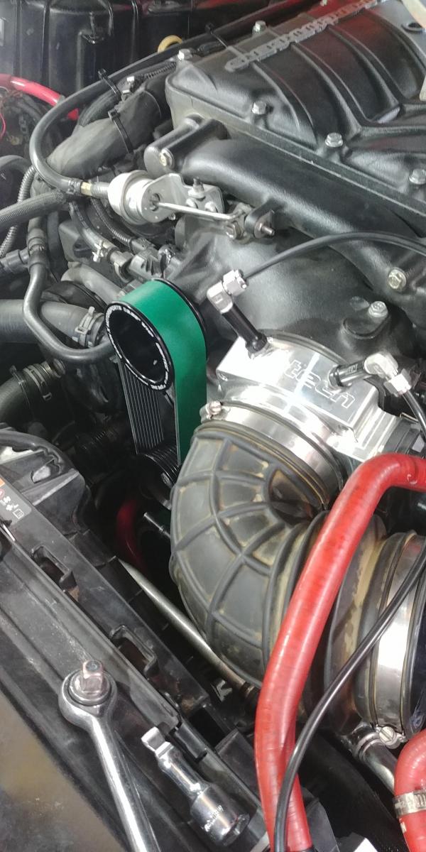

Finally, attached

Originally Posted by shinysun View Post
Attachment 940617
Finally, attached
How'd it workout with your setup since we are pretty close? Good gains?
I didn't get my car dyno yet, and I changed the lower pulley to 8" and the upper pulley to 3" in order to max the rev out. I worried about the belt slip , so used Griptec pulley. I am not sure about the gains from TB only due to changed alot at the same time, but feels not bad.
The boost level is 17~18 PSI and totally quite fast now, however experiencing trans slip. :(
Did you need a spacer to use the TB on the Whipple? Does a stock Whipple work with the TB, or did you have the snout ported?
Nope. Not at all. You just need to remove the adaptor included in the sc set.
