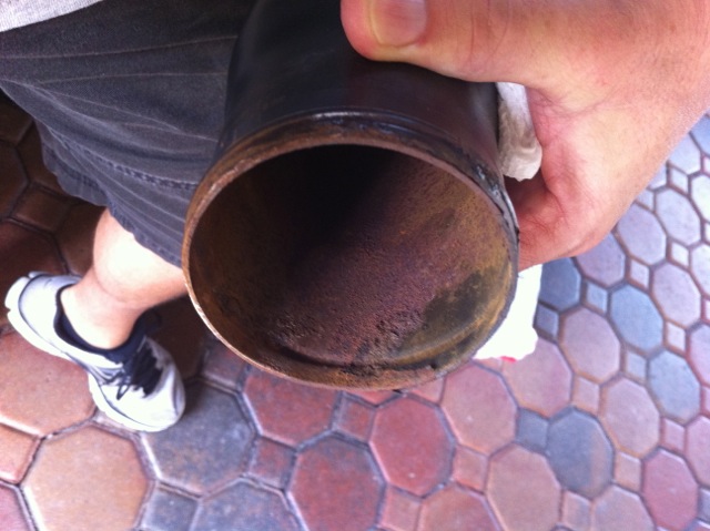

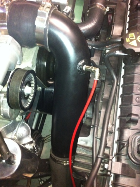

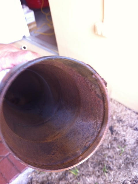

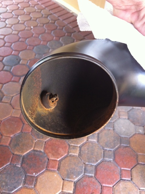

A few pics of corrosion from meth
Here is a great write up of a car with methanol and what it can do to some metals. I am not tryig to scare anybody, just trying to inform. SGDM is also trying to give as much info as he can to help the topic
http://www.camaro5.com/forums/showthread.php?t=319342
