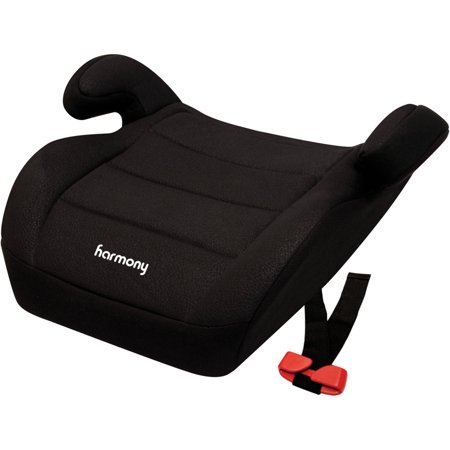

Trunk lid handle and booster seat. Difficulty is a 3 outta 10:
I missed the handle on my BMW and Lexus so I didnt have to get my hands all dirty (winter salt etc) when closing the lid. I installed a strap that I raped off of my kids booster seat. $13 at walmart, and free handle! I just ripped it off the seat - its supposed to hold onto the seatbelt or something, I dunno, I never will use it. BTW, this booster fits great in the seats of the SS and my stingray.
If you pop off three of the topmost trunk lid push trees, you'll have enough access to the underside of the lid. The plastic around the latch just pops off. I made the strap about 6" long and melted two holes at each end with a lighter and hot poker. Inside, I removed the central nut that secures the wing, and placed the straps over the stud.
The nut has an encapsulated and rotating washer, which was perfect to give the straps a bit more strength. Here the strap is secured and you can see the backside of the 1" slit I made at the corner of the trunk lid liner.
Here it is installed, and it works awesome! No more dirty fingers. This mod took me about 30 minutes, and no cost.
